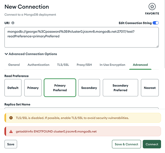

The connection string copied from Atlas:
mongodb://george:%3Cpassword%3E@cluster0.jrzcmr8.mongodb.net:27017/test?readPreference=primaryPreferred
I dont have mongosh installed, so I have tried connecting from the command line.

The connect string from Atlas does not seem to be correct for the Compass version you are using
Check/tick appropriate version while choosing the connect using Compass method
It would have given you SRV type connect string

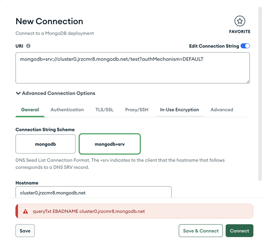

I selected v1.12 or later which gives the connect string:
mongodb+srv://george:@cluster0.jrzcmr8.mongodb.net/test
but that also does not work:
May be some dns or firewall issue
Did you try from another location or diferent network,wifi or mobile hotspot
Many thanks for your input. I tried connecting via ExpressVPN and it works! I spent hours trying to resolve this issue, and I still dont understand why re-directing via ExpressVPN solves the problem.
You have a uncooperative DNS server. Either the one you use directly or one upstream from it if it forwards queries. Not an uncommon problem seen here.
If you want to NOT use a VPN then get the DNS server fixed, updated, replaced.
For work, get the IT team involved, these are basic DNS records that have been around for years and should be used.
For home, check that routers have up to date firmware/software. Try different DNS servers; google’s, OpenDNS’s. Or you can run your own DNS caching server.
If you have a particularly obnoxious ISP who intercepts DNS then VPN might be the only recourse to using mongodb+srv:// URIs/
