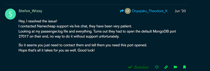

I’ve not used cPanel in the past but it appears it is a hosting platform which means you may require them to allow outbound traffic to ports 27015 to 27017 as noted here. Additionally, you can see from the following post here that it appears the cPanel support (Namecheap?) unblocked port 27017 which resolved the issue. Hopefully this helps in your case. You may also want to ensure the client attempting to connect from the cPanel end is on the Network Access List for the project.

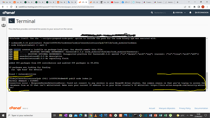

Hi
I followed your instructions: port 27017 is not blocked and the ip address is on the network access list.
Here is the information you requested:
- Connection method: MongoDB driver version 4.4.1
- Error message
- [senechoicetours-shard-00-01.ovhwy.mongodb.net:27017]
Thanks in advance
Thanks for providing those details. Could you provide the output from the ping and telnet commands from that client? I cannot see the output from either from the screenshot you attached? This will at least help confirm some level of connectivity from the cPanel client to the Atlas cluster’s node(s).
If the hostname:port of the PRIMARY is the value you provided here, then the commands that should be run from the cPanel client are:
ping senechoicetours-shard-00-01.ovhwy.mongodb.net
telnet senechoicetours-shard-00-01.ovhwy.mongodb.net 27017

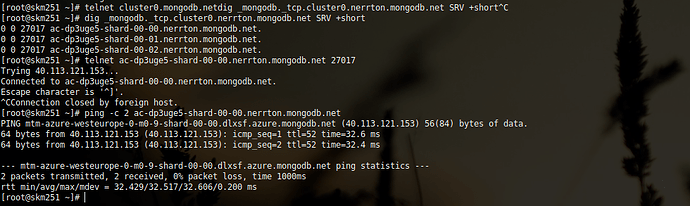

I have the same problem with Cpanel
Everything is working on localhost and cyclic.sh.
But, if I try to run the same simple app it doesn’t connect.
err = new ServerSelectionError();
MongooseServerSelectionError: Could not connect to any servers in your MongoDB A tlas cluster. One common reason is that you're trying to access the database fro m an IP that isn't whitelisted. Make sure your current IP address is on your Atl as cluster's IP whitelist: https://www.mongodb.com/docs/atlas/security-whitelist /
