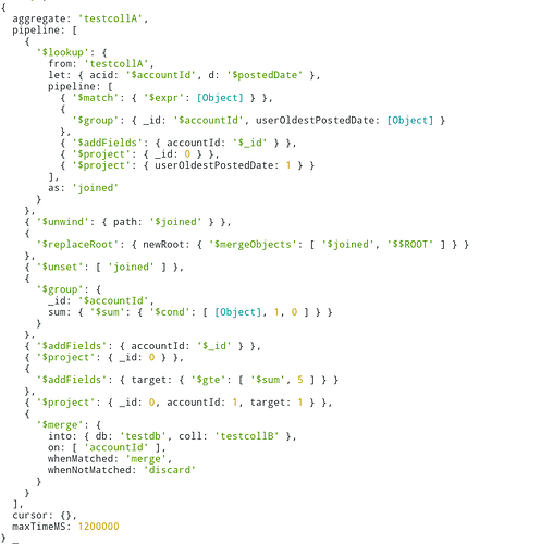

I tried it on another query and i cant see the contents of an arrays/objects.
Formating is very nice its what i wanted,but i cant see all the query.
How to print the complete query?
I got this from JSON.parse(‘myJSON’) on mongosh

Hello
Thank you for the reply
I am using mongosh version 0.6.1
I run it from ubuntu terminal
Query(random aggregate command,that i wanted to send to forum yesterday) =
{"aggregate":"testcollA","pipeline":[{"$lookup":{"from":"testcollA","let":{"acid":"$accountId","d":"$postedDate"},"pipeline":[{"$match":{"$expr":{"$eq":["$accountId","$$acid"]}}},{"$group":{"_id":"$accountId","userOldestPostedDate":{"$min":"$postedDate"}}},{"$addFields":{"accountId":"$_id"}},{"$project":{"_id":0}},{"$project":{"userOldestPostedDate":1}}],"as":"joined"}},{"$unwind":{"path":"$joined"}},{"$replaceRoot":{"newRoot":{"$mergeObjects":["$joined","$$ROOT"]}}},{"$unset":["joined"]},{"$group":{"_id":"$accountId","sum":{"$sum":{"$cond":[{"$lte":[{"$subtract":["$postedDate","$userOldestPostedDate"]},2592000000]},1,0]}}}},{"$addFields":{"accountId":"$_id"}},{"$project":{"_id":0}},{"$addFields":{"target":{"$gte":["$sum",5]}}},{"$project":{"_id":0,"accountId":1,"target":1}},{"$merge":{"into":{"db":"testdb","coll":"testcollB"},"on":["accountId"],"whenMatched":"merge","whenNotMatched":"discard"}}],"cursor":{},"maxTimeMS":1200000}
JSON.parse(‘Query_above’) and console.log(Query_above)
Prints the same,query is very well formated but i dont see some embeded arrays/objects
Here only objects in previous query i had arrays and objects.
Also the below is Javascript Object,it would be nice to have valid JSON with keys as strings.
So people can copy paste it.
Solving this is important for the forum also,so far i am sending hard to read MQL code,because
i dont know a way to produce compact MQL code.
Hi @Takis,
Thanks for sharing the sample doc, which helped reproduce the issue. I looked a bit further into the shell implementation and tracked this quirk down to max recursion depth which is currently set to 6 by default: format-output.ts#L162.
It looks like this default was chosen to provide a balance between performance and visible data.
However, you can call util.inspect() directly and provide a depth of “null” (unlimited) to recurse up to the maximum stack size:
util.inspect(json,
    colors: true,
    depth: null
If you think it might be useful to have a configurable (or larger) default, please raise a suggestion on the MongoDB Feedback Engine and comment here with the link so others can watch and upvote.
Stennie
