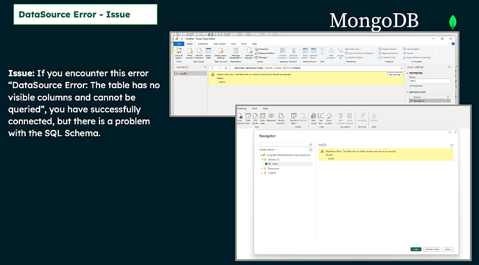

I am able to connect using the mongodb adapter to PowerBI. I can select the table in power query but get the following error:
DataSource.Error: The table has no visible columns and cannot be queried.
Details:
Orders
I verified that the table was populated using Compass.
Any help would be appreciated.

i have the same problem.
Some collections work, however, the new ones don’t!

Hello @Airwolf39_N_A and @logikoz ,
Welcome to The MongoDB Community Forums!

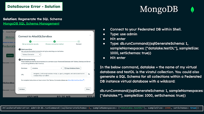

Please check if SQL Schema is generated as the most common reason to this error is that the SQL Schema needs to be generated. Could you try running sqlGenerateSchema command on collection, and see if that clears up the error
To run the sqlGenerateSchema, you must do so from the admin db. Here are some instructions that might help.

Can you help me?
When I run this command:
AtlasDataFederation admin> db.runCommand({ sqlGenerateSchema: 1, sampleNamespaces: ["database.twitterpublicmetrics", "database.twitterpercentages", "database.twitternewmetrics"], sampleSize: 1000, setSchemas: true })
I got the following error:
MongoServerError: not authorized, correlationID = 17986eab79db73f1f569e2e2
What can I do to resolve this?
