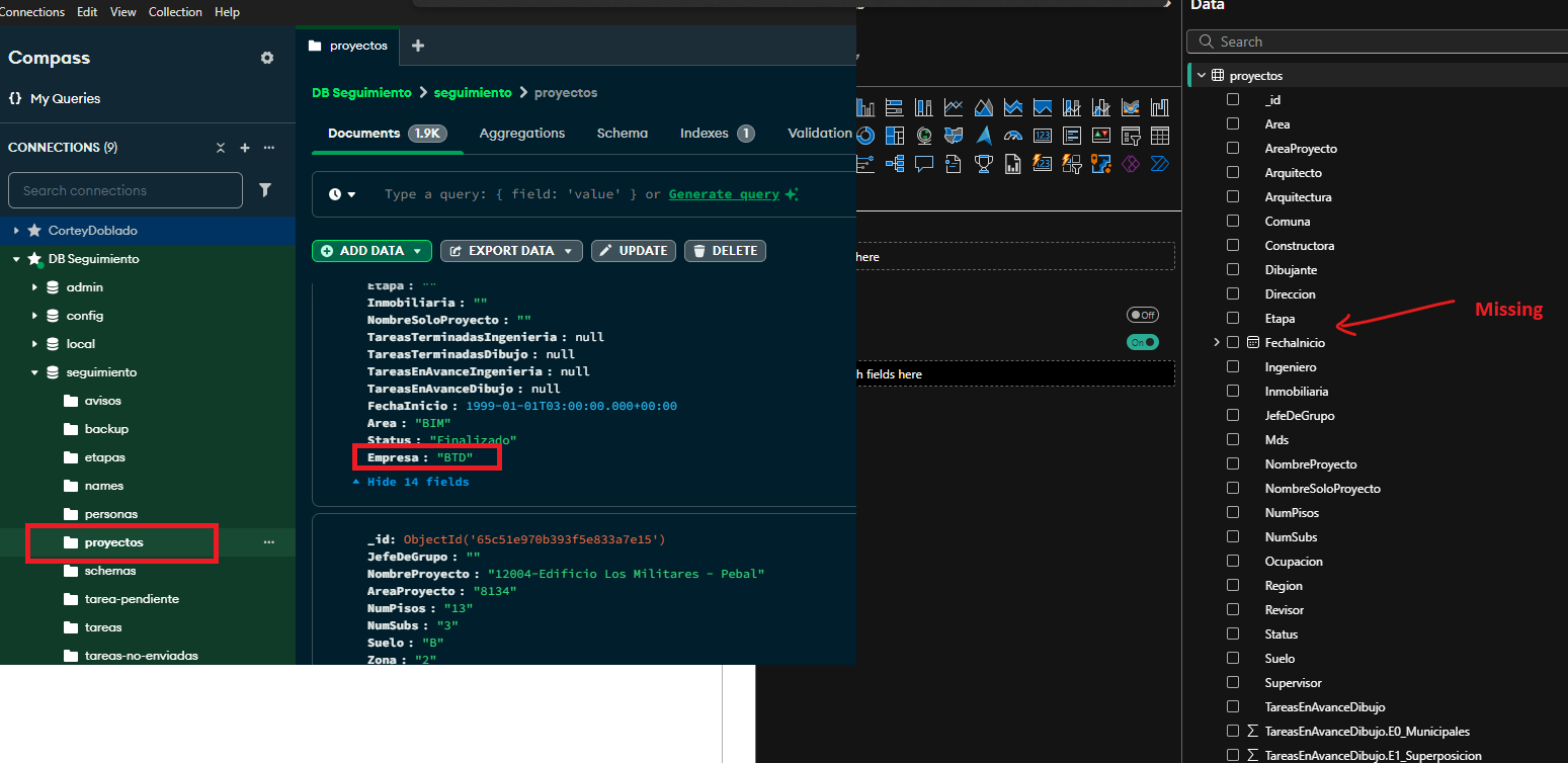

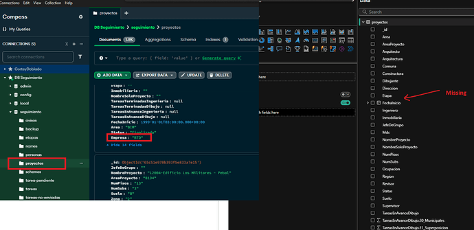

Hi, Im using a local mongoDB in my server and im conecting it to PowerBI using mongosqld and ODBC conector.
It has been working amazing until I added a parameter in a collection.
This parameter cant be found anyware in powerBI, but I do find it using Mongo Compass.
Any thoughts?
The collection is “proyectos” and the atribute is “Empresa”
