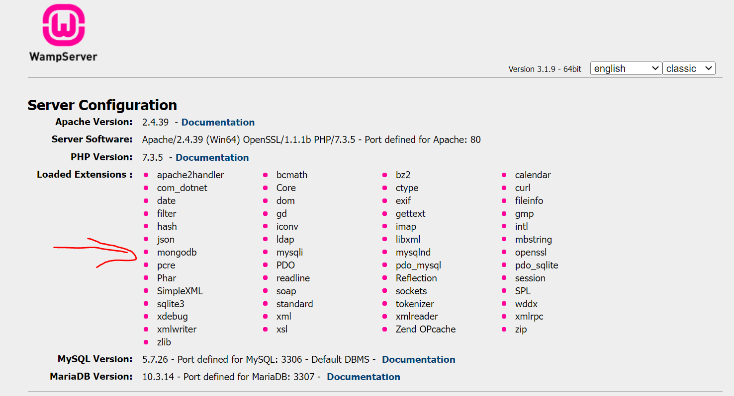

Thanks for your response @Hubert_Nguyen1 , I not using a compose I downloaded a DDL file from php.net . below is my php info.
@Wilbard_Mtei ,
The MongoClient class has been deprecated:
http://php.adamharvey.name/manual/en/class.mongoclient.php
Using the most recent PHPLIB, the init code looks like this:
$client = new \MongoDB\Client(CONNECTION_STRING );
There’s a great PHP setup tutorial here
https://www.mongodb.com/quickstart/php-setup
And another one that shows how to perform CRUD operations:
