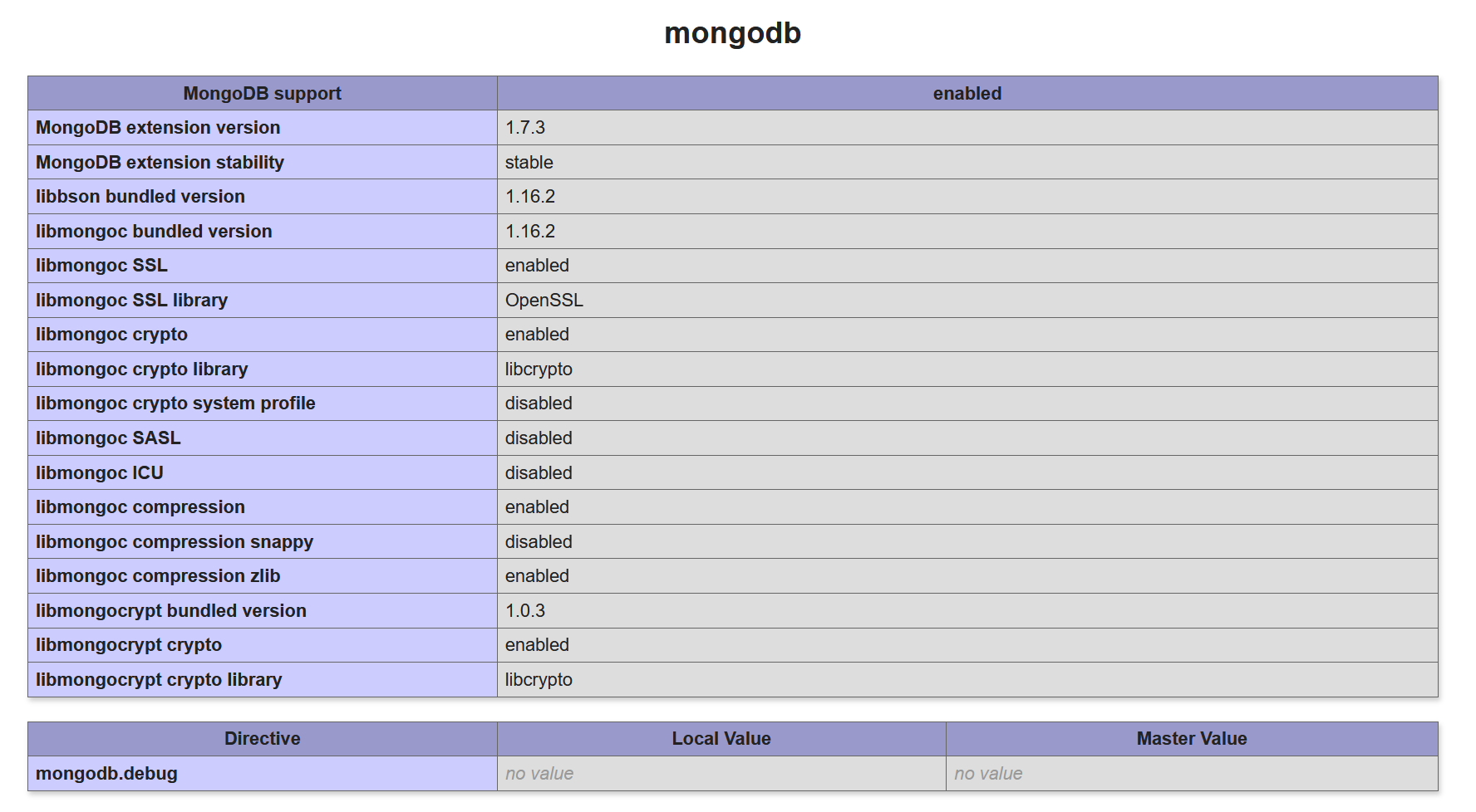

I have tried to install the mongodb php driver over apt install php-mongodb and the installation has worked without any problems. Under phpinfo(); i can see that the driver is installed.
