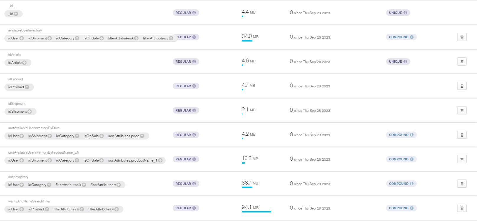

Indizes

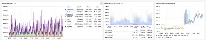

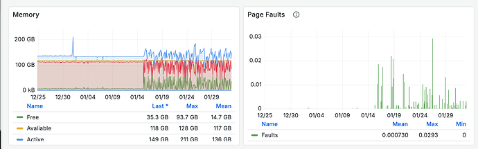

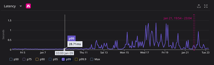

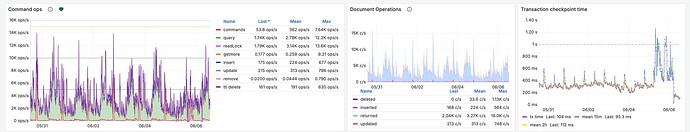

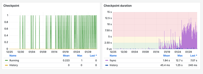

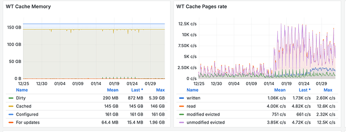

We have experienced the same issue with an upgrade to version 7.0.1. Unexplainable slow queries that often result in timeouts. Here is an example showing the P99 performance of one of our APIs, you can easily guess when we upgraded to 7.0.1:
After downgrading to version 6.0.13, everything is back to normal.
We didn’t upgrade the fCV to 7.0 though, as we can’t go back from there. I wonder if the issue persists with fCV 7.0?
When I stop all write operations to the database, the performance seems to be OK with 7.0.1. (The performance issues are observable even when we don’t hit the IOPS limits of the SSDs.)

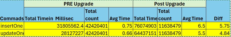

Performance degraded from upgrading Mongo 4.0.6 to 7.0.5 using (java sync driver)
  • 7.0.5 upgrade updateone and insertOne performance degraded 7X times below is matrix we have analyzed before and after.
