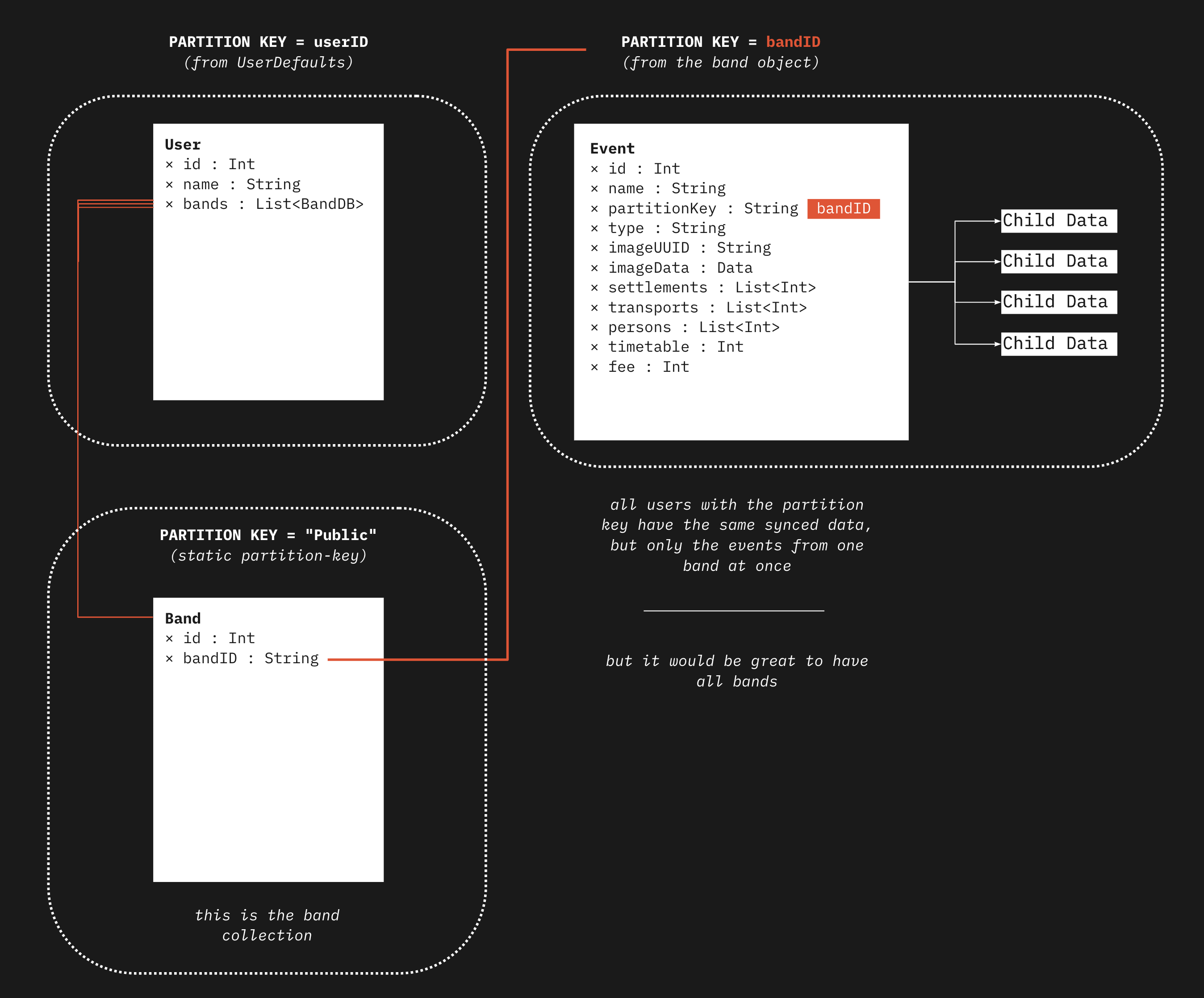

Currently I am struggeling with my partitioning strategy and maybe you can give me a hint how to improve it.
Basically my app is meant for bands to plan their gigs. So you as a User can log in and you are assigned to one or more Bands. Every Band also can have one or more Events. To simplify things I have made a litte schema to visualize my data-structure.
As you can see, I use a partition-key for my current user and this user has a list of bands, where I can append and remove them. (This pattern is from the documentation in the Relations: Many-To-Many section).
From the bands Object I can take the bandID and pass it as a partition-key for all of the events each band has. This does somehow conform to the way team realms should be partitioned (based on the documentation).
  • The big advantage is, that I only need the partition key for having all events loaded at once, for every band and member.
  • But the disadvantage is, that I only can display events from one band at once, due to the limitation of only be able to use one partition key (or bandID) at once.
But I somehow need that behaviour in the app. When you are in for example two bands at once, the overview should show all events they are assigned to.
Things I tried/thought of so far to solve this:
Trying to use multiple partition-keys at once — I think this is not a very elegant solution for the problem, but I tried, haha
Appending the Events also to the Band as a List — this was the most valueable solution up until now, but I think there will be syncinc issues bc the events no longer will be a top-level object. Instead they’ll become a children of band and grandchildren of user.
Somehow use Realm Triggers — but there I have no clue in wich way they could help me, I just have seen them in different tutorials and articles like RChat.

Yes — you are right. The band collection is accessed with a static and public partition-key. Every Band has a bandID which is a UUID as String This is then used to:
  • Append the Band to the user’s band-list.
  • Recieve the corresponding Event data, because every event also has the partition-key from the band, so that when you are in a band every event gets loaded.

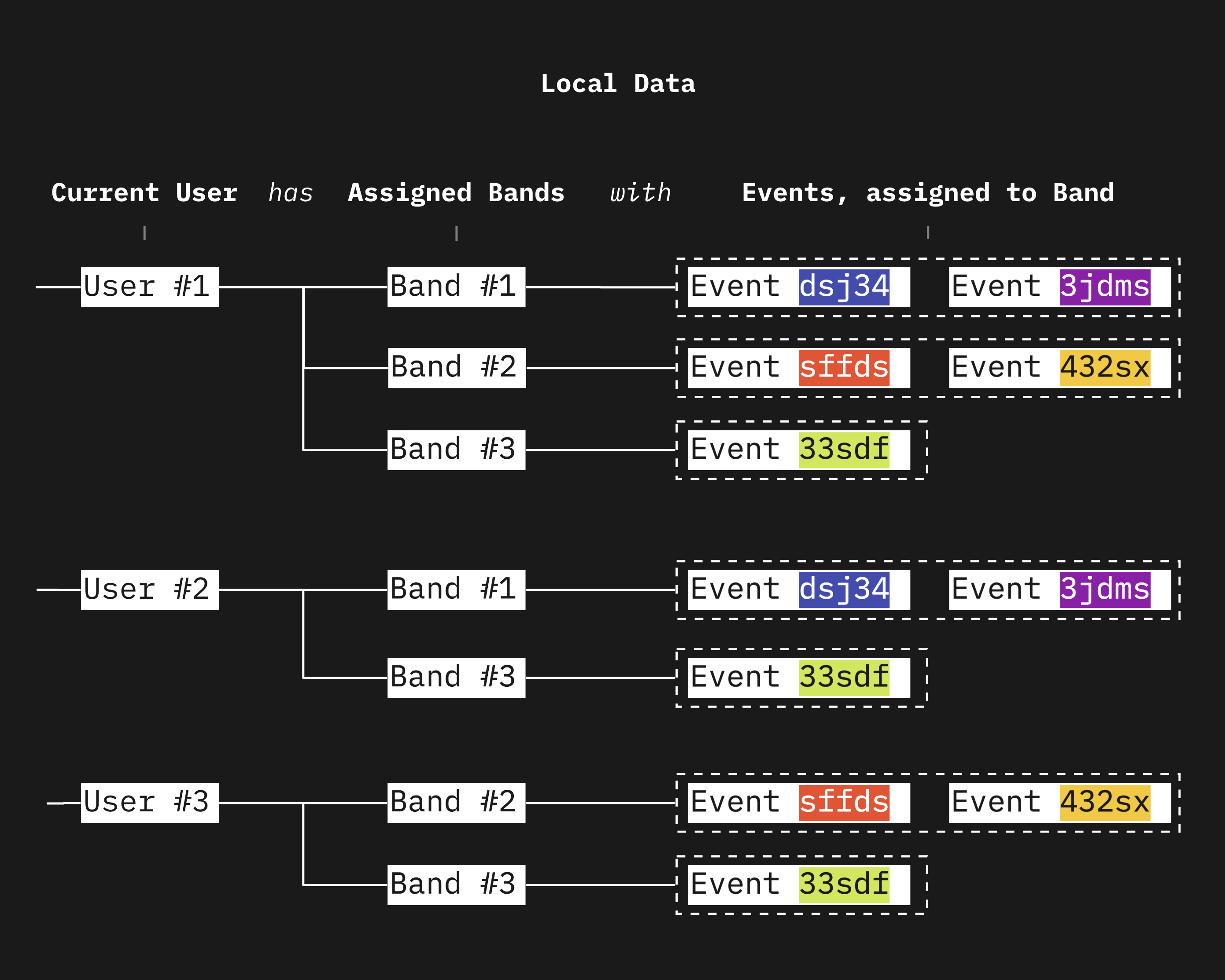

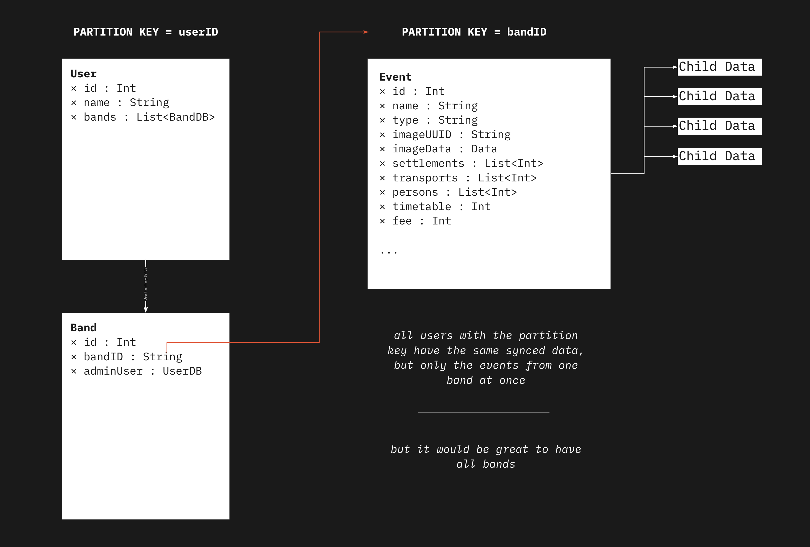

I also updated the graphic to get you a deeper context of my current approach.

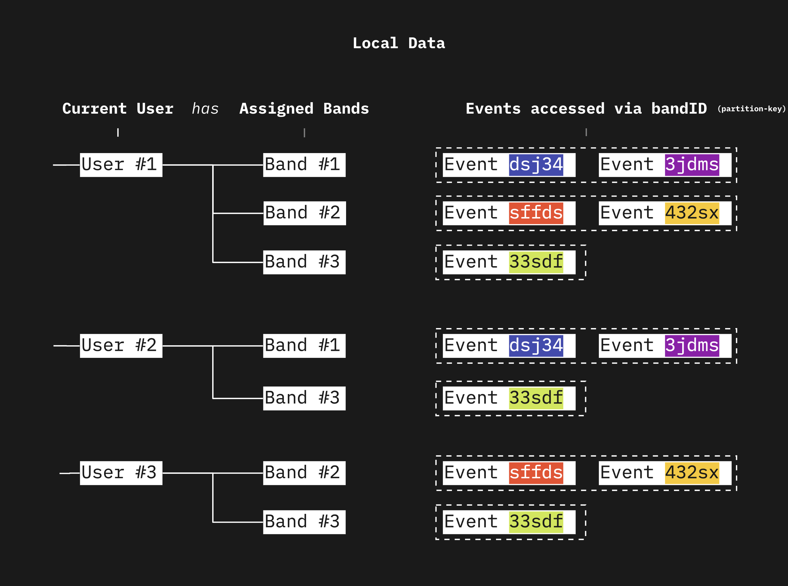

If the first visual explanation is not sufficient enough, here is another one which is displaying the data structure I have at the moment.

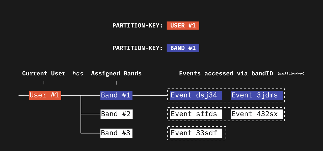

Due to my usage of my partition-key I am limited to only get data from one band at once, like shown here. GIF
Possible approach to this problem:
I would like to append the events to the bands for each and every user. After that the user only will need their UserID as a partition-key. This seems to be straight forward. But — if User#1 is editing Event dsj34 and commits it’s changes to the database, with his unique partition-key, will User#2 recieve the changes?
