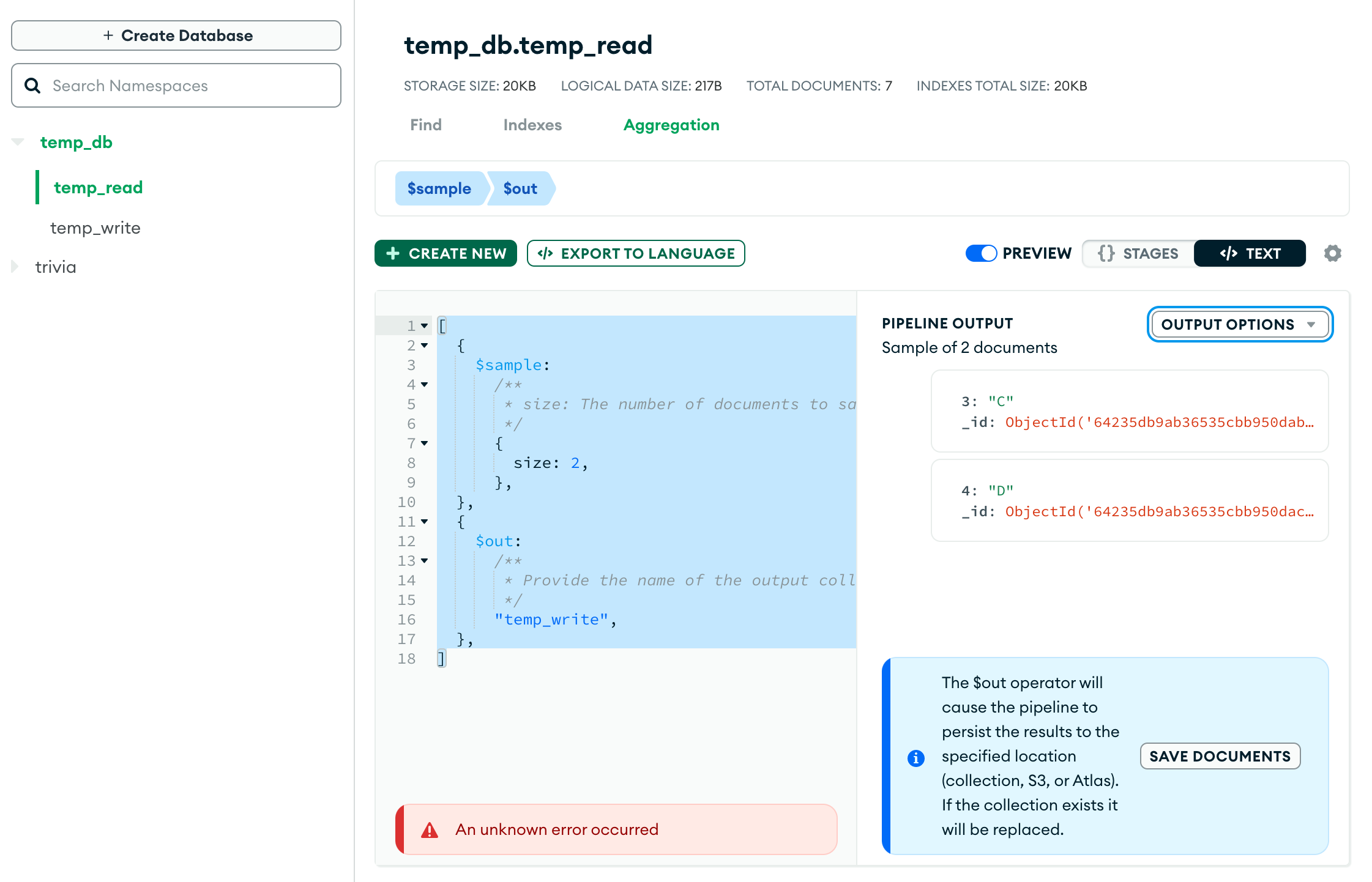

Using Atlas aggregation wizard on a sample collection, the $out stage returns
An unknown error occurred
When running the aggregation inside a function, the result is:
(AtlasError) $out is not allowed or the syntax is incorrect
Code here:
exports = function(payload, response) {
const mongodb = context.services.get("mongodb-atlas");
const readColl = mongodb.db("temp_db").collection("temp_read")
const writeColl = mongodb.db("temp_db").collection("temp_write")
const myAgg = readColl.aggregate([ { $sample: { size: 2 } }, { $out: "temp_write" } ])
return myAgg
Any advice from the community?

Hi @enjoywithouthey ,
Can you share the pipeline and which sample collection you used?
Also which cluster Tier are you using in Atlas and which version ? Anything out of the ordinary with your cluster?
My Tier is $0.1/1M Serverless
The sample data I made up. It’s in a collection I’m calling temp_read
I’m selecting some random documents and pushing them to an empty collection called temp_write
$merge in a previous pipeline worked fine. $out is giving errors.

Pipeline:
$sample:
$out:
"temp_write",
Thanks for your help!
