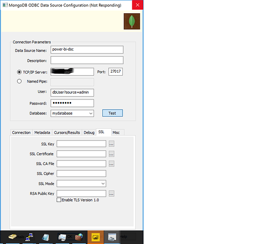

I have installed mongo DB in Linux operating system(CentOS 7), I am configuring ODBC 32 bit connection in windows machine, when I test it is not responding, I have tried ODBC 64/32 bit and also tried with unicode and ascii option. I am not sure with what i am doing. I have also attached screenshot for connection details. Logs are not generating. Do i miss any configuration in ODBC like TLS or SSL?
Welcome to the community @Vidya_Sagar_Reddy,
The MongoDB ODBC Driver for BI Connector also requires a compatible version of the MongoDB Connector for BI to be installed and running.
What are your installed versions of MongoDB ODBC driver, Connector for BI, and MongoDB server?

The MongoDB BI Connector connects to the MongoDB server on port 27017 and will bridge the NoSQL nature of MongoDB and make its data visible as sort of virtual tables. ODBC driver then connects to the MongoDB BI Connector, typically on port 3307.
so try 3307 instead 27017
Please install MongoDB Connector for BI MongoDB BI Connector Download | MongoDB and then:
“C:\Program Files\MongoDB\Connector for BI<VERSION>\bin\mongosqld.exe” and:
2021-12-02XXXXXXXXXXX I NETWORK [initandlisten] waiting for connections at 127.0.0.1:3307
ODBC will work fine on port 3307

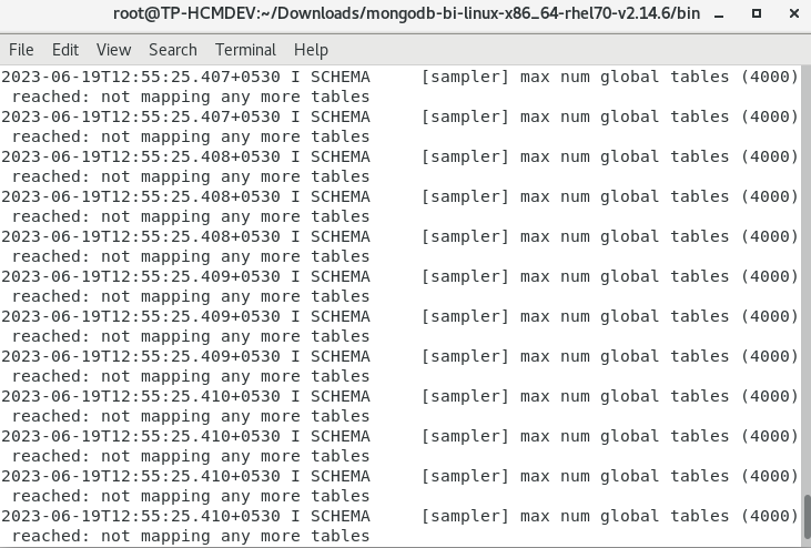

I am facing same issues. I have connected at 127.0.0.1:3307. But not fully loaded databases in ODBC driver. Unknown database error. I am not able to connect. Please refer the screenshots and version
OS : Centos 7
MongoDB Version :
MongoDB shell version v4.4.18
Build Info: {
“version”: “4.4.18”,
“openSSLVersion”: “OpenSSL 1.0.1e-fips 11 Feb 2013”,
“modules”: ,
“environment”: {
“distmod”: “rhel70”,
“distarch”: “x86_64”,
“target_arch”: “x86_64”
The Mongo DB server port all are good. I can connect via Compass which uses a JDBC and is a success. Does MongoDB atlas support ODBC driver 1.4
