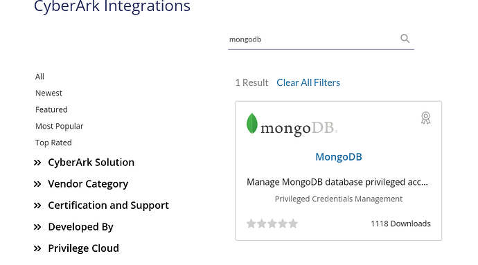

This is the plugin I am looking at.
https://cyberark.my.site.com/mplace/s/#a3550000000EiBoAAK-a3950000000jjUOAAY
It’s hard to see what this is about given that it’s paywalled, but browsing around I’m wondering if this plugin does anything other than credentials management?
It is a CPM plugin, CPM servers are what do credential rotation/verification only.
