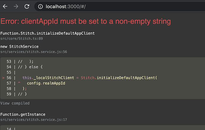

I tried removing the code that uses it in stitch.service.js,
…but then I get a different error

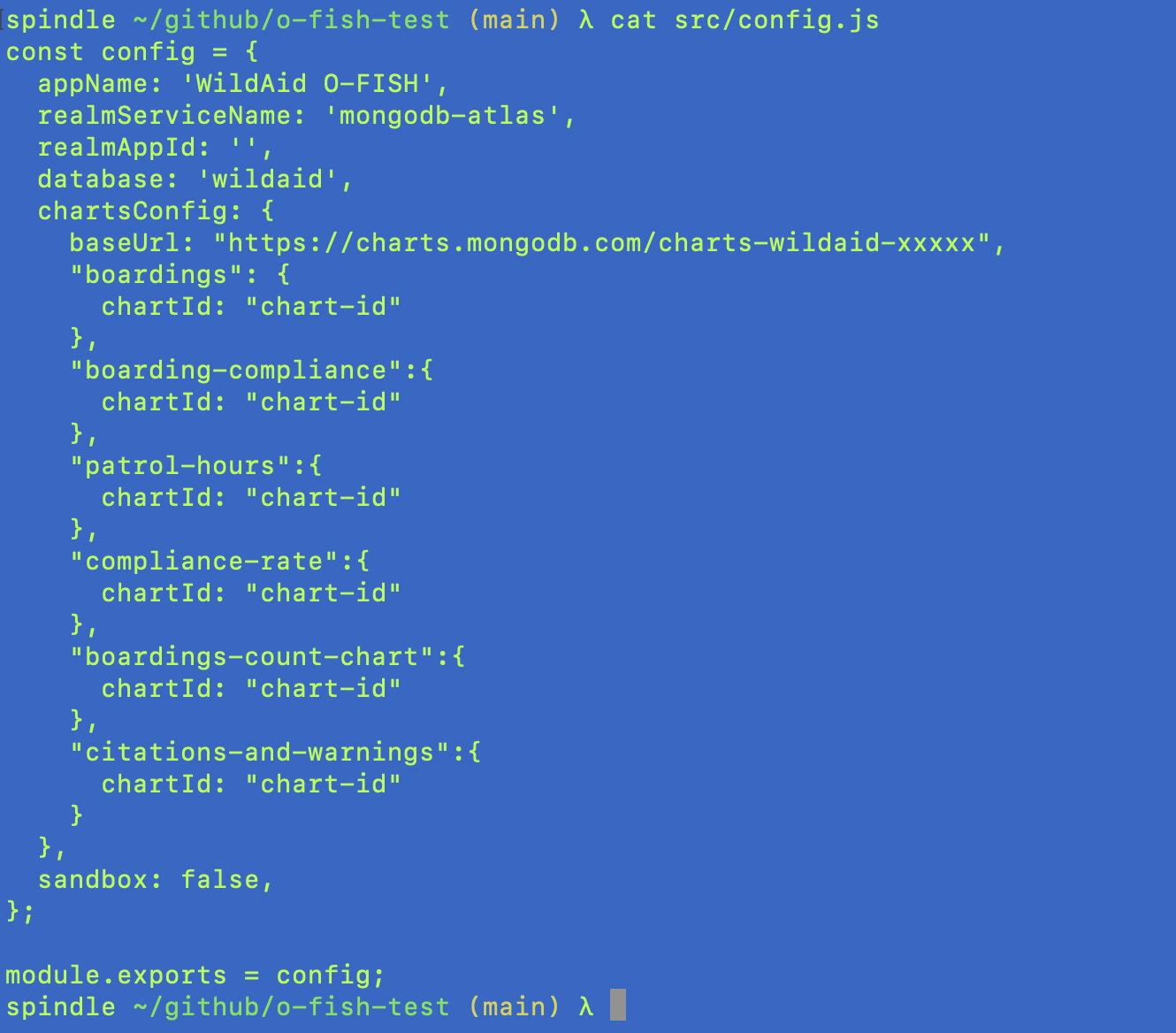

Hi Lenny,
I was able to reproduce the issue if I checked out the code, copied src/config.js.tmpl to src/config.js, and built, without adding any custom information to the src/config.js file:

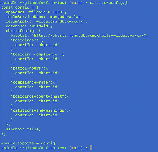

When I change the realmAppId line to have the sandbox, the build works fine…
so I changed
realmAppId: ‘’,
to
realmAppId: ‘wildaidsandbox-mxgfy’,
and ran npm start again.
Here’s what my config file looks like after the change:
Hope that helps!
