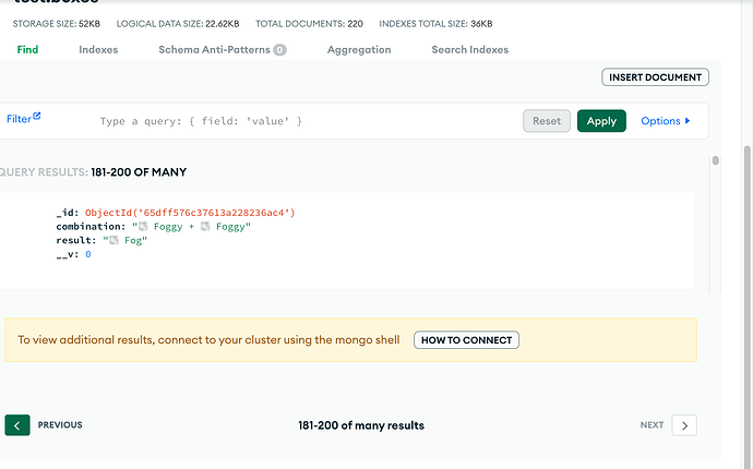

I need to see my results past 200 index so I can check if the most recent ones are correct or not. But it’s not showing. I connected it already, does this problem have to do with my free trial? Idk.
Have you tried what the screenshot tells you to do?
Which is
To view additional results, connect to your cluster using the mongo shell.
Clicking the button HOW TO CONNECT will tells you how to connect. The mongo shell IS NOT your node.js project.
