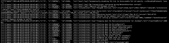

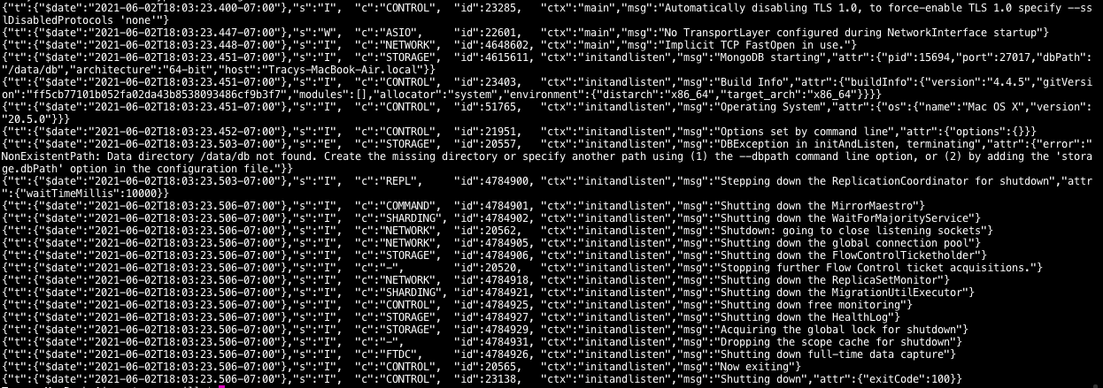

Hello, thank you for your help. I ended up getting it to start loading again but it still wont boot up. I typed in pgrep Mongod and nothing came back. Here is the result of trying to boot up Mongod now.
It says /data/db dir not found
Give another dir path and check
mongod --dbpath new_path (say your home dir)
or change your config file to use a path where mongod can read/write
Also in Macos they removed access to root folder /data/db
Please check documentation.You have to use a different path for dbpath

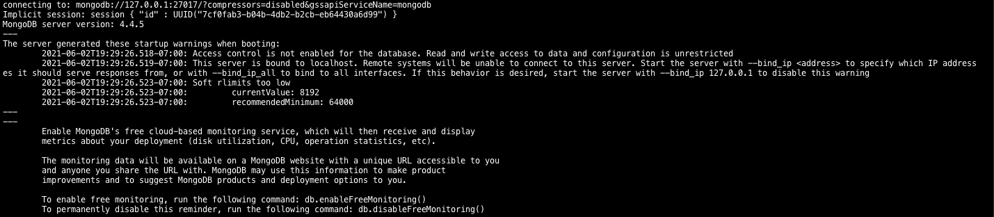

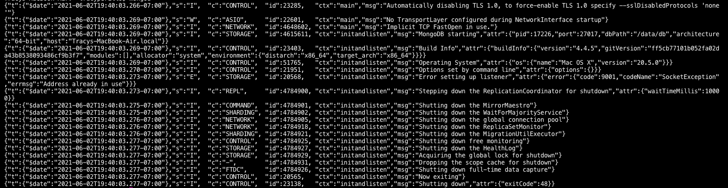

I am still getting some errors. I switched the dbpath and I made sure it was changed in the mongo.conf file. I also have this “disabled” in the mongo shell when trying to connect. This is what was happening to me last week before I uninstalled and had trouble even booting. I googled so much and tried a lot of stuff but I am so new to mongo or even using the terminal it is very overwhelming.
The error says address already in use
When you run mongod without --port param it tries to bring up on default port 27017
Looks like you have another instance already running on this port
You can try to bring up your mongod on a different port
mongod --port 28000 --dbpath your_path bind_ip 127.0.0.1
Please note when you try to connect to mongod you have to specify the port if you brought up mongod on a different port other than default
mongo --port your_port
Please check documentation for the warning messages you got like access control etc
To secure your mongod you have to use auth parameter
