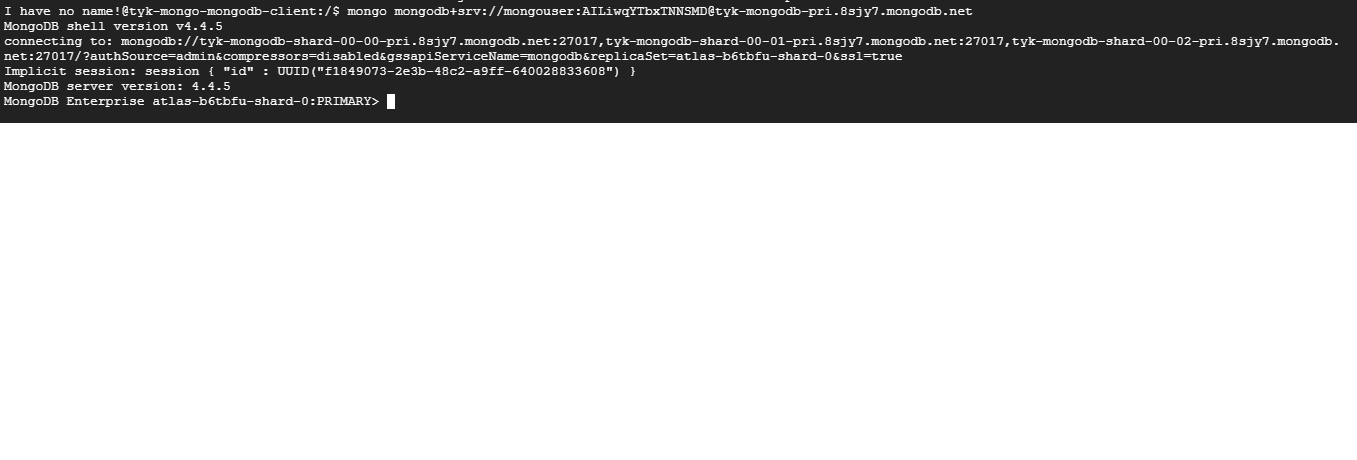

The image shows I am able to connect to it after I deployed a pod with mondb-clients in it. (Don’t worry, I already changed the password).

So by performing the connection this way, and I used the private connection (you can see the -pri in the name above), this means all my connectivity is flowing via the VPC peering that I have established. Is this correct? Hence less risk of data being sniffed across the wire.
