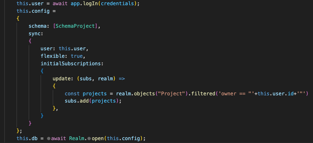

I’ve read a few similar posts here and the docs but I’m still missing something. I get the following error when trying to create/write my first Realm object to my DB:
RealmError: Cannot write to class Project when no flexible sync subscription has been created.
I was reading the Node SDK and just following along with it to understand how to create a subscription. I’m not sure I need to actually create a filtered subscription that looks for objects with current user’s ID in the owner field but I felt like that’s a reasonable way to get started.
I have no data in the DB for this object, this is my first attempt at running Realm. Thanks for any help… But, it seems I’m creating a subscription and I have flexible sync / dev mode enabled in the backend.
Here’s what I have so far:
Screenshot 2023-06-13 at 8.11.20 PM
Screenshot 2023-06-13 at 8.11.37 PM
Can you try using the subscriptions update API instead of using initialSubscriptions? Follow the guidelines from the docs here: https://www.mongodb.com/docs/realm/sdk/node/sync/flexible-sync/#std-label-node-sync-subscribe-to-queryable-fields
Specifically, update the subscriptions using something like this:
await realm.subscriptions.update((mutableSubs) => {
  mutableSubs.add(longRunningTasks, {
  mutableSubs.add(bensTasks);
  mutableSubs.add(realm.objects("Team"), {
    throwOnUpdate: true,
I did just test the initial subscriptions syntax that you’re using, and it appears to work. Can you also confirm the version of the realm SDK that you’re using?

Ok excellent, moving the subs code into a step after the open, it now works. I verified that my test write (create a project object) worked and I can see it in my DB… very good.
Thanks a ton, pasting code below as it might help someone learning Realm as I am.
