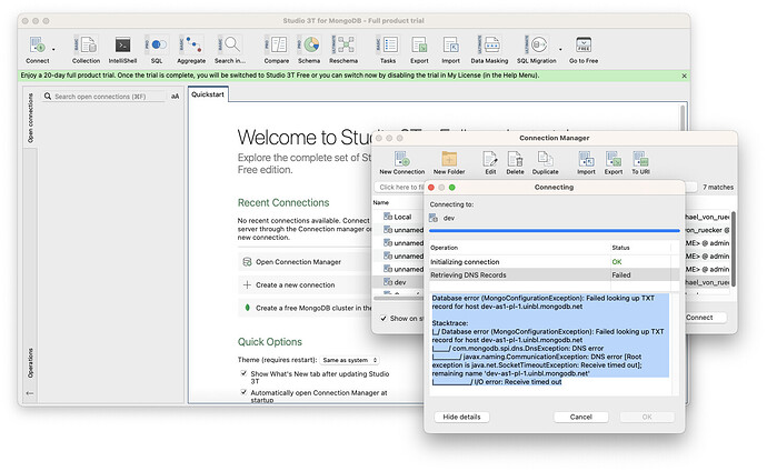

My IntelliJ fails to access http://dev-as1-pl-1.uinbl.mongodb.net/, but using MongoDB Compass, I can access it. Any thoughts to help me out. I

I’m unsure about the Atlas cluster:
atlas-b8iu73-shard-0
I can access it using MDB Compas but not S3T. I tried to add my IntelliJ log file, but I was blocked in doing so.
I am using the DNS Seed List connection Format: ST3 fails,
I cannot send the S3T Details
The error itself and the message from Studio 3T indicates a DNS resolution failure - In particular it looks like a TXT lookup is failing. I’m not too familiar with Studio 3T itself but is it possible you can use the standard connection string format to see if you can connect? If it connects, then its most likely a DNS issue (although it’s strange since you’re able to connect using Compass from the same machine I assume) although again, I am not too familiar with Studio 3T and it’s inner workings.
