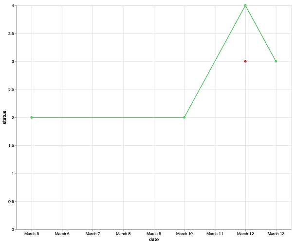

Hi all
I’ve made the line graph as you can see above. The issue is that there are only data points for the 5th, 10th, 12th, and 13th. How can I modify the chart so that dates that don’t have data are defaulted to show data points at 0 (zero)?
Any help would be appreciated. Thank you!

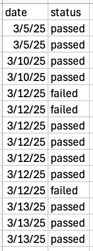

hey… welcome! Can you share the data model - possibly some sample documents? We might be better able to assist if we understand the structure of the documents.
Hi! Thanks for reaching out. We are only using two fields - ‘date’ and ‘status’. We are executing a test and recording which day it executed and whether the test passed or failed. Above is the data in the database.

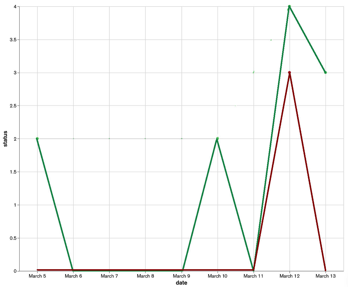

This is an example of the output we are looking for. Each date should have the ‘status’ set to zero if the test didn’t execute. Is it possible to get this output?
Ok… so I put this together in response… hope you find it helpful.

2. Create the Chart in MongoDB Charts
Step-by-Step:
  1. Go to MongoDB Charts and log in
  2. Create a new Dashboard
  3. Add a data source: choose the charts_demo.status_log collection
  4. Click “Add Chart” → Select Line Chart or Discrete Line
  5. Switch to Library mode in the top bar
  6. Paste in the following aggregation pipeline:
    $group: {
      _id: { date: "$date", status: "$status" },
      count: { $sum: 1 }
    $group: {
      _id: "$_id.date",
      counts: {
        $push: {
          k: "$_id.status",
          v: "$count"
    $project: {
      _id: 0,
      date: "$_id",
      counts: { $arrayToObject: "$counts" }
    $densify: {
      field: "date",
      range: {
        step: 1,
        unit: "day",
        bounds: "full"
    $addFields: {
      "counts.passed": { $ifNull: ["$counts.passed", 0] },
      "counts.failed": { $ifNull: ["$counts.failed", 0] }
Click Apply.
3. Configure the Chart Layout
  • X-Axis: date
  • Y-Axis:
    • Add counts.passed (Aggregate: Sum)
    • Add counts.failed (Aggregate: Sum)
  • Leave Series blank
  • Customize title: “Test Results per Day with Missing Dates Shown”
Final Result
You’ll see a line chart showing:
  • Test result counts (passed/failed)
  • All days between March 5 and 13, including zero-count days
Michael, thank you so much for this solution! It’s very detailed, easy to understand, and did exactly what I needed it to. It seems that I need to learn more about aggregation, which I’ll have to find some documentation on.
Thanks again
