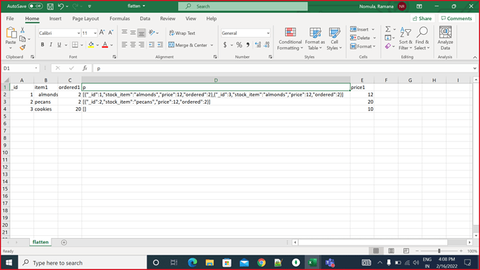

Hi All,
We have received requirement in MongoDB to flatten array of json.
Could you please help us by providing the sample code to flatten the below array of json(refer to column p).

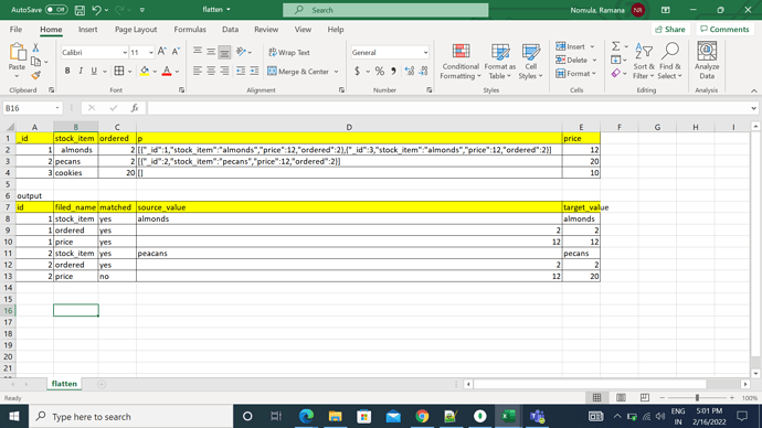

Hi @alexbevi,
Thanks for quick response.
We need the output in below format,.
flattening json field and comparing with source columns.

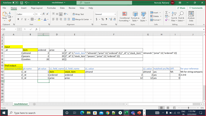

Hi @alexbevi,
Thanks for quick response, please find the below updated expected output as we have some changes in the expected output(highlighted in yellow colour).
In some scenarios, there is possibility of different column names, for example, stock_item is compared to item as shown in above screenshot.
Could you please modify your query logic according to the updated output.
