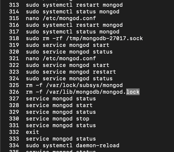

My mongodb server failing to start/restart
I’m using a ubuntu VPS only for MongoDB.
I recently installed mongodb from official site.
I changed few configs like adding security etc… and it was working fine.
Few days later, today when I made a minor change in config and restarted the service. It suddenly stopped working and even after reverting the change, its still the same.
DB contains some data that is very previous to me, so i can’t just start over :sob:

Hey, I think I may have deleted the .lock file myself after seeing some answer in stackoverflow, before starting out here.
I searched for lock in output of history command and found this:
I’m not sure how bad is it, but I definitely want to get over this :sob:
Is this still solvable and/or data is recoverable.
