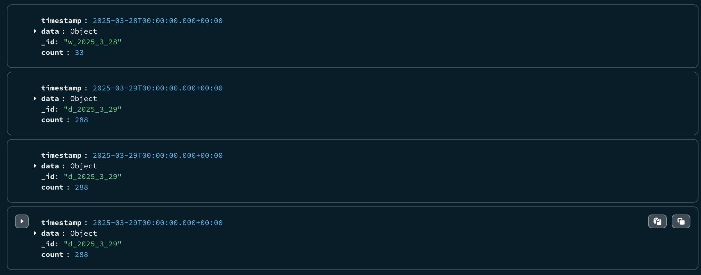

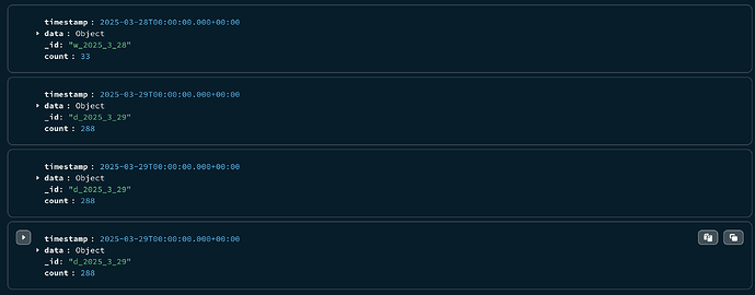

Hello there, I am working with pymongo on a project that inserts time series data into a collection, with an _id field based on the date, a string generated by me instead of the default ObjectId.
However, I have come across the fact that multiple documents with the same _id can be added to the collection. How is this possible? Could it be a bug or is it something on my end?

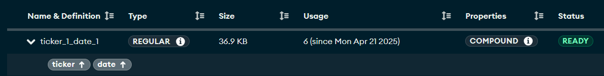

will create a time series collection with a compound index on ticker & date, which are the metaField and timeField above. Using db.getCollection("stocks").getIndexes(), gives:
[ { v: 2, key: { ticker: 1, date: 1 }, name: 'ticker_1_date_1' } ]
Again, note that it’s not a unique index and no index on _id is listed above.
