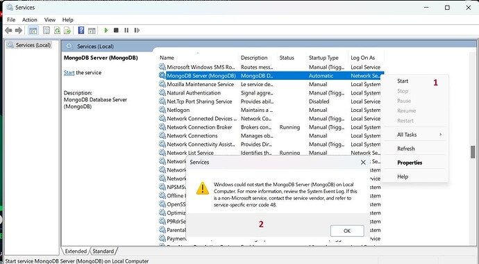

Hey Kushagra, When I open windows services console I find that MongoDB service is stopped but I can’t get it to start here’s the error I get:
I tried the solutions mentioned in that similar stack overflow post but those commands didn’t work
Check mongod.log.It will show more details on why it is failing
Did you try to rebot your system?Since it is configured to start auto it should come up after a reboot
Hey, I fixed the issue, it was node using the default port in the background, once I killed it’s process and ran mongod, the shell connected normally, thanks for the help.
