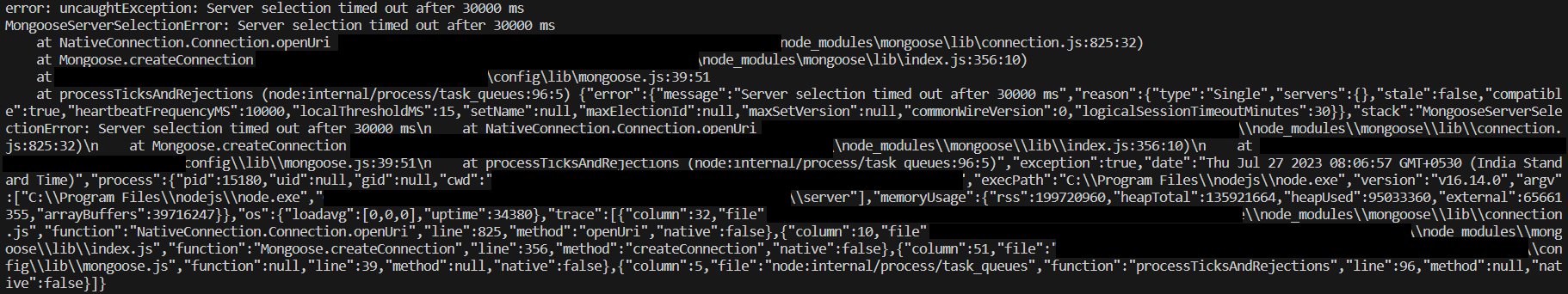

MongoServerSelectionError: Server selection timed out after 30000 ms.
I am using node version 16.14.0 and mongoose version of 6.11.4. I am getting the same error repeatedly. I have checked the mongodb server also it is working fine.

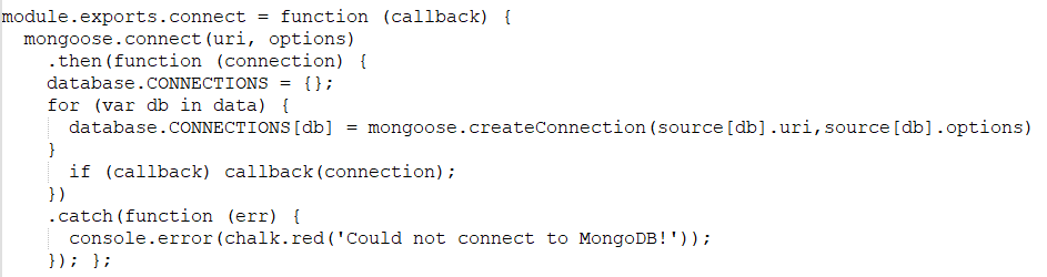

MongoServerSelectionError: Server selection timed out after 30000 ms. In my project I use try catch block. In the try block first I use mongoose.connect to connect to the master DB and then parallelly I try to connect to my other data bases using mongoose.createConnection. In the old version of mongoose which is 5.10.3 the same is working fine. When I updated my mongoose to 6.11.4 the same above mentioned error is occuring. Please support the above issue.

The same code was working with earlier version of mongoose which is 5.10.3. When I have updated to the 6.11.4 the same was throwing an error. Refer the below image
Help me in this case if you find any solution
