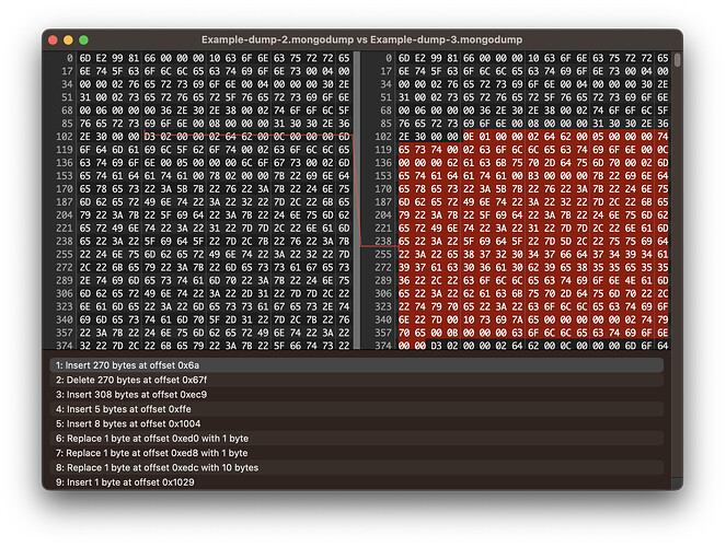

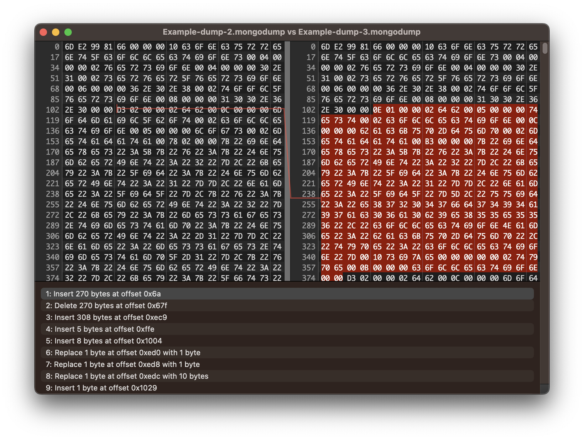

I have examined the dump in a hex editor, and I have found that the 32-bit integer 858927154 is equivalent to the hex 0x33323032, which, when encoded, translates to 2023. The database contains quite a few dates, so it’s hard to know exactly where the problematic data is in the file. The last date in the file occurs here:
32303233 2D30372D 33315431 353A3035 3A30312E 3539322B 30303030 09646F6E 65206475 6D70696E 67207175 696C746D 635F6D6F 646D6169 6C2E6C6F 67732028 37313120 646F6375 6D656E74 73290D0A 45000000 02646200 10000000 7175696C 746D635F 6D6F646D 61696C00 02636F6C 6C656374 696F6E00 05000000 6C6F6773 0008454F 46000112 43524300 AD1DD5DB A30C5FCD 00FFFFFF FF
Which encodes to:
2023-07-31T15:05:01.592+0000 done dumping quiltmc_modmail.logs (711 documents)
Edbquiltmc_modmailcollectionlogsEOFCRCÕÛ£_Íÿÿÿÿ
I’m not sure if this is the cause, though, because the file has a similar “done dumping” message for each time the process finishes dumping a table.
I did create a dump of another database for testing purposes, which I’ve verified that I can restore. It was created in a newer version of MongoDB (6.0.8 100.6.0), but I noticed that it lacked the “done dumping” messages. I also noticed that the test dump ended with:
454F4600 01124352 43000000 00000000 000000FF FFFFFF
which showed in the hex editor as EOF CRC ...., meanwhile, the corrupted database shows as
454F4600 01124352 4300AD1D D5DBA30C 5FCD00FF FFFFFF
which showed in the hex editor as EOF CRC . ... _. .....
I did try and replace the corrupted file’s file end with the working file’s, but this didn’t seem to work.
