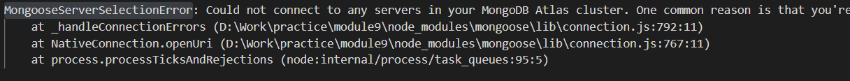

I am trying to upload one of my full stack applications on render.com since heroku free hosting is dying , although the uploading is successfull , i get this error when deploying the server side of my app.
It says my Ip may not be whitelisted , however it very much is , i even did allow access to any IP and it still wouldnt work …

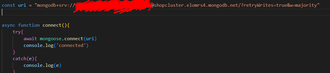

May i also mention i am using mongoose in nodejs with express
And also M0 Sandbox (General) cluster tier
this is what i get , so i assume the request is made successfully and i do get a response , however mongodb has not connected i guess

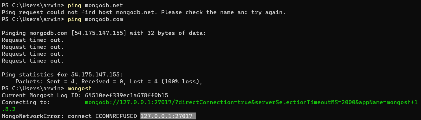

Despite using the given connection string and whitlisting all IPs I’m not able to connect to the Atlas Cluster.
How do I proceed with this ?
If you running a VPN try stopping it.
If it is still does not work, turn off your firewall.
I’ve tried that too. It still doesn’t work. I am unable to run the mongodb shell too.
Unable to find a solution for these errors.
Why do you ping mongodb.net or mongodb.com while you try to connect to local instance at 127.0.0.1?
Where do you want to connect exactly?
I was just trying to test my connection to mongodb.net
Since all server connection strings end with that.

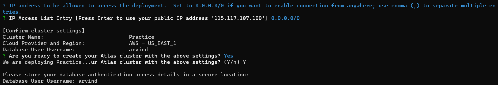

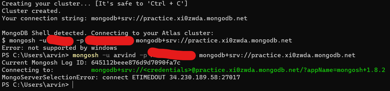

I’ve used the Atlas CLI to create a cluster, and even that isn’t able to run any mongosh commands.
Anything else I should try out to test the extent of the issue ?
I was able to connect successfully to your cluster. This means the issue is on your side of the connection.
Are you sure you are not using a VPN?
Try a different internet provider.
Ohhh
Okay…
I’ll try a mobile network and see if the issue persists.
Thank you, this work for me

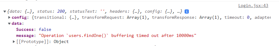

Hey, but I am not using render right now. I am just trying to run it locally. Still I am facing the same error.
