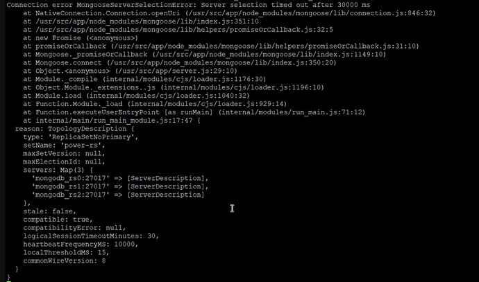

s Version 14.2.0 Mongoose Version 5.9.6
me also can you help me in this error

It did worked for you because you are connecting to an Atlas cluster. The other person is not using Atlas.
replace local host with 127.0.0.1 it work every time

Hi all,
This kind of error has many root causes but its occurring “sometimes” might be related to the number of connections opened to DB servers. the default number is 64K (65536) and can be changed in the config file under net.maxIncomingConnections
Configuration File Options — MongoDB Manual
If your app does not use a singleton client or does not close connections after querying, at some point total connections to the database will accumulate and reach a point where it won’t accept new connections anymore until old ones are closed/expired.
for example, if the driver opens 100 connections for each request by default, then only about 655 of them will be served and the 656th connection (and over) will be refused as it can serve only 36 more (for default).
