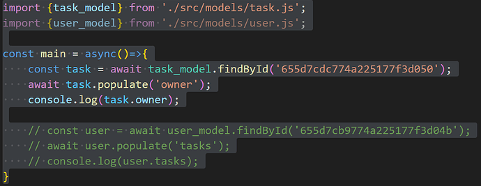

I’m using the latest version of mongodb and mongoose and populate() is working fine…
mongodb: 6.3.0
mongoose:8.0.1
This is from my app.js file
This is from my task model file
const task_schema = new mongoose.Schema({

This is from my task router file
//creating a task...
router.post('/tasks',auth, async (req, res) => {
    const task  = task_model({
        ...req.body,
        owner: req.user._id
    console.log(`Url tasks is hit with request....`);
    try {
        const savedTask = await task.save();
        res.send(savedTask);
    } catch (err) {
        res.send(500).send(err);
This from auth middleware file
const auth = async (req, res, next) => {
    try {
        const token = req.header('Authorization').replace('Bearer ','');
        const decoded = jwt.verify(token,'secret123');
        const user = await user_model.findOne({_id: decoded._id,'tokens.token':token});
        if(!user){
            throw new Error();
        req.token = token;
        req.user = user;
        next();
    } catch (err) {
        res.status(401).send(`You are not authorized ${err}`);
Hope it helps…
