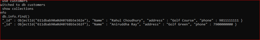

Database and collection in mongoshell
use customers
switch to customers
show collections
info
db.info.insertMany( [
{ Name: “Aniruddha Ray”, address: " Golf green", ph: 9811111111 },
{ Name: “Rahul Chiudhury”, address: “Golf course”, ph: 7922222222 }
field_name.txt file(field.text)
Name
address
phone
Field directory where I saved field_name.txt file > C:\Users\Arindam PC\Documents\field_name.txt

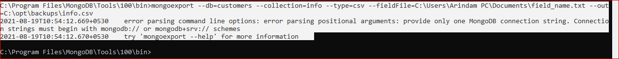

mongoexport command-line option to get output in csv format
mongoexport - - db=customers - - collection=info - -type=csv - -fieldFile=C:\Users\Arindam PC\Documents\field_name.txt - -out=C:\opt\backups\info.csv
Error: 2021-08-19T14:36:18.090+0530 error parsing command line options: error parsing positional arguments: provide only one MongoDB connection string. Connection strings must begin with mongodb:// or mongodb+srv:// schemes

It is a syntax issue
There are spaces in your command
Put the command in a notepad and remove the spaces before each parameter and run the command again.It will work
    • db is not same as --db
I have not used any space in the command while usuing the --mongoexport command in mongo shell. Please see the screen shot. In the forum I use space intentionally to clarify two - - lines. I use --db not - -db in mongo shell.

He did because you have an error and we are trying to help you figure out what you do wrong. In this case the error seems to be misleading as it says to specify only 1 connection string. I do not see any on your command. And according to https://docs.mongodb.com/database-tools/mongoexport/ you do not need to specify any when connecting to localhost at the default port. By looking in more details, I see that your --fieldFile argument has a space in it. You should put it in double quotes.

The command in your screenshot did not have extra spaces but we were thrown off because you wrote
You had an extra space between every pair of dashes. You also add and extra space before db= and collection=.
And why Notepad. Because it is easier to edit a command with an editor rather than the command line.
