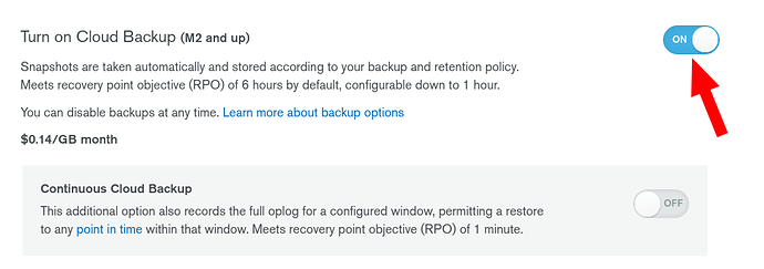

If you are running on MongoDB Atlas, the easiest way to backup your data is simply to activate the Cloud Backups.
