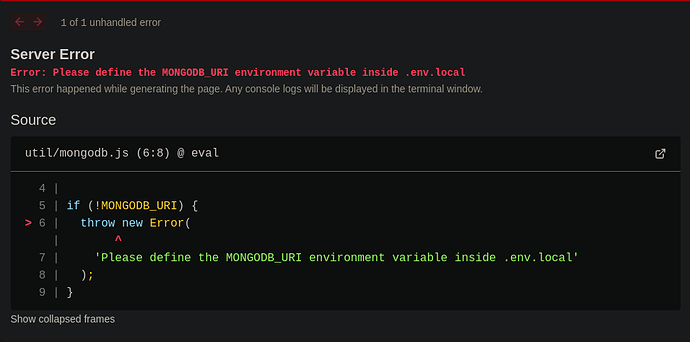

Hello,
I’m following this small tutorial to learn Next.js and MongoDB in detail. However, I’m encountering some issues with the following in this tutorial. I’m trying to use the .env.local.example from the file to the mongodb.js. I rechecked both of my Atlas clusters and connect it to the Compass. The compass shows all of the data and I can see the sample_mflix fine. My only issue is that it doesn’t show through the landing page. Thanks for your help :slight_smile:
this is the content of .env.local.example:
MONGODB_URI=mongodb+srv://test:test@cluster0.tdm0q.mongodb.net/sample_mflix?retryWrites=true&w=majority
MONGODB_DB=sample_mflix
Welcome to the MongoDB community @Zeid_Tisnes!
Per the tutorial, make sure you rename or copy .env.local.example to .env.local after adding your configuration. Try renaming the file and restarting your Next.js app with npm run dev.
Stennie
I did change the name to .env.local but still no luck with Authentication failed error message. Even though I have the same credentials. I’m a little bit lost and confused because it is literally what the tutorial shows.
Ok, apparently the URI I had initially was not working and I had to change it to this instead:
mongodb+srv://test:test@cluster0.8nlmr.mongodb.net/sample_mflix?authSource=admin&replicaSet=atlas-ance8p-shard-0&w=majority&readPreference=primary&appname=MongoDB%20Compass&retryWrites=true&ssl=true
