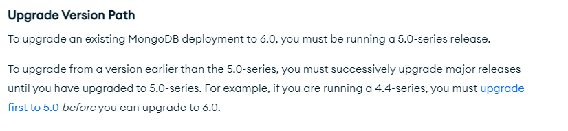

  1. Development server has windows 2012 operating system, and we can’t upgrade mongo past 4.2 correct? Looks like there is a restriction
  2. TEST and PROD has windows 2019 and current mongo version is 4.4. Planning to upgrade both to 6.0. Any known issues in latest versions?
    3.ANy issues with backups and restores?
    Please let me know. Thanks
  1. When upgrading you can’t skip major versions you have to go from 4.2 → 4.4 → 5.0 → etc.
    https://www.mongodb.com/docs/manual/release-notes/6.0-upgrade-replica-set/

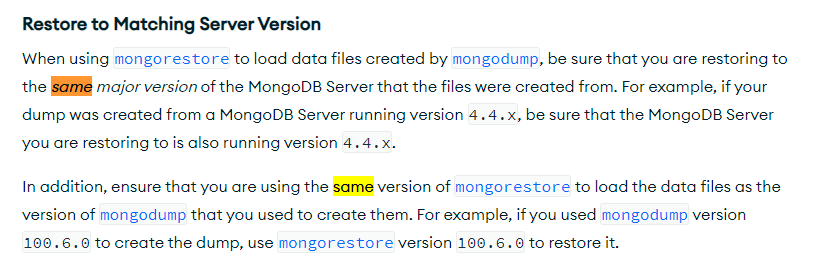

I use mongodump in batch files for daily backps.
Thanks alot for your detailed reply
It that case I would look into the mongodump/restore docs as it says to restore/dump to the same major version of MongoDB.
