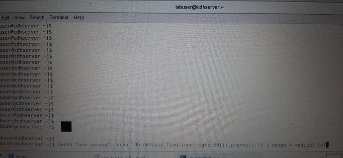

I have loaded a json file in mongo then i have performed some operation on that data and i have to save the query result into a textfile but when i am runing that query in mongo shell it is working fine and showing me data as per the condition but when i come out of mongo shell and try to store my query data into txt file it is showing syntax error. I am using eco
What error are you getting and how are you trying to extract the data? Redirect console output from a shell or using mongoexpprt or something else?
Redirecting consol output from shell .
And whats the error? Whats the command you are running?

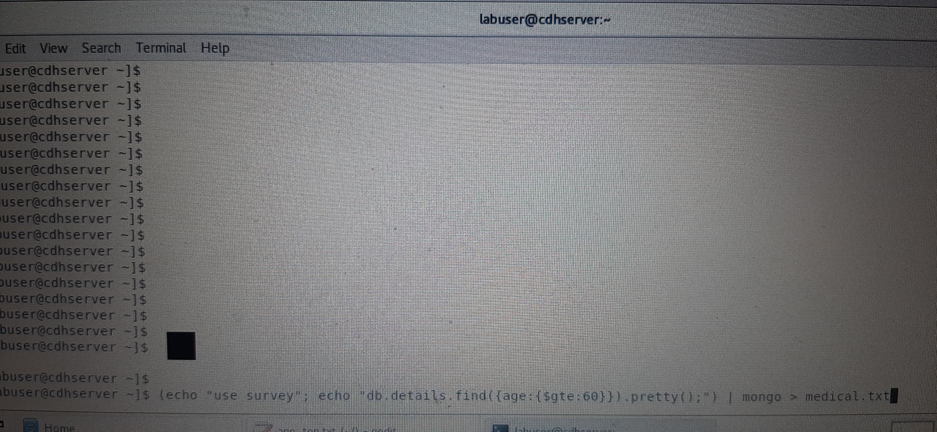

(echo “use survey”; echo “db.details.find({age:{$gt:60}})”) | mongo > medical.txt

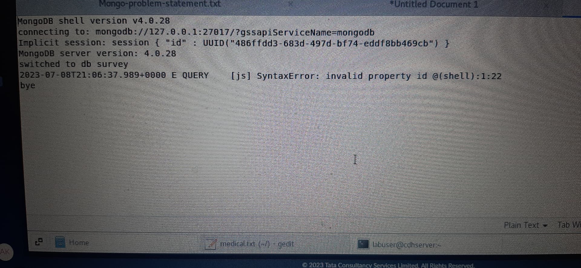

In medical.txt file its showing syntax error
Can you paste the error exactly you’re getting?

in bash script ‘$’ has a functionality so you have to use the escape sequce before it ''
try
