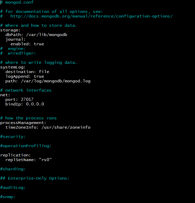

The contents of the file /etc/mongod.conf
when you run systemctl? You try to connect to localhost,
I didn’t understand what you said. I am trying to connect to the server via SSH connection.
Unless your mongod is up and running you will not be able to connect by mongo shell or compass
Are the servers where you ran sudo systemctl and mongo command are same?
