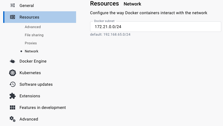

<houseadm@houseadms-iMac scripts % docker container inspect 0c64d3267a22 | grep 'IPAddress'
"SecondaryIPAddresses": null,
"IPAddress": "",
"IPAddress": "172.21.0.2",
houseadm@houseadms-iMac scripts % docker container inspect 280b455a3abe | grep 'IPAddress'
"IPAddress": "",
"IPAddress": "172.21.0.4",
houseadm@houseadms-iMac scripts % docker container inspect 0fe371970fe0 | grep 'IPAddress'
"IPAddress": "",
"IPAddress": "172.21.0.3",

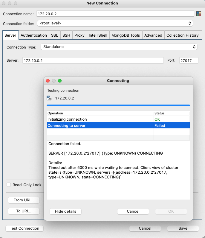

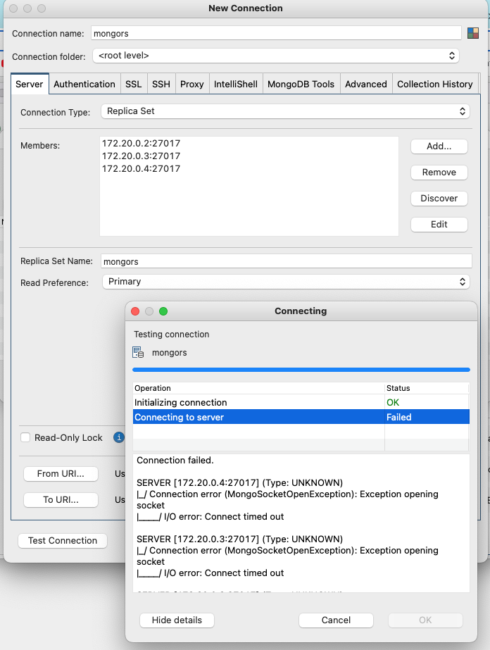

Another when a try to connect using mongosh or connect to replica set
houseadm@houseadms-iMac scripts % mongosh "mongodb://mongodb1:27017,mongodb2:27017,mongodb3:27017/mongodb?replicaSet=mongo-replica"
Current Mongosh Log ID: 64b76a37fd5bf937a6cca38f
Connecting to: mongodb://mongodb1:27017,mongodb2:27017,mongodb3:27017/mongodb?replicaSet=mongo-replica&appName=mongosh+1.10.1
MongoServerSelectionError: Server selection timed out after 30000 ms
houseadm@houseadms-iMac testcompose % mongosh "mongodb://mongodb1:27017,mongodb2:27017,mongodb3:27017/database?replicaSet=mongo-replica"
Current Mongosh Log ID: 64b6930329ab4371a505f7b4
Connecting to: mongodb://mongodb1:27017,mongodb2:27017,mongodb3:27017/database?replicaSet=mongo-replica&appName=mongosh+1.10.1
MongoNetworkError: getaddrinfo ENOTFOUND mongodb1

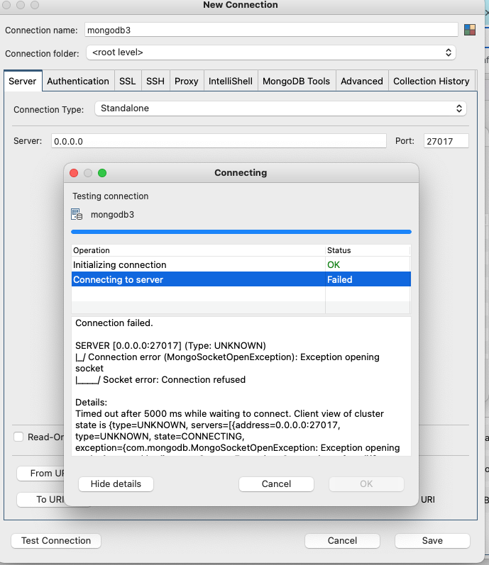

An interesting point to share is that through Studio 3T, the connection via node is also successful, as well as via “docker exe”
I hope I managed to share all the procedures performed in search of a workaround solution. But without success…
