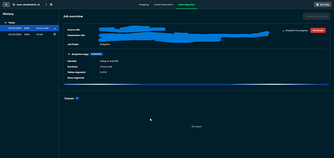

I am currently facing an issue with MongoDB Relational Migrator that I hope to get some assistance with. My goal is to export a database into MongoDB, but I am running into a roadblock during the migration process. Despite multiple attempts, the migrator consistently gets stuck at the “Snapshot” stage and fails to write any data.
Here are the steps I’ve taken and the problems encountered:
  1. The migration tool enters a loop at the “Snapshot” stage, making no progress regardless of the time allowed (up to 7+ hours in one instance).
  2. No rows are being written to my MongoDB server during this stage, as confirmed by multiple attempts.
  3. I have tried a migration with a minimally filled database (about 10 entries per table) to no avail.
  4. Conducting the migration from a different host, such as localhost, as opposed to my production host, has not resolved the issue.
I give you a screenshots that illustrate the problem I am experiencing with the tool.
I am reaching out to the community for any advice, insights, or solutions that could help resolve this issue. Has anyone encountered a similar problem, or can anyone suggest troubleshooting steps that might overcome this hurdle?
Any help would be greatly appreciated. Thank you in advance for your time and assistance.

Hello Yassine,
Do you mind sharing the version of Relational Migrator you’re using? I would recommend using the latest if you’re still facing issues. The newer releases displays the progress of the migration job.
A few things you can try to troubleshoot further:
  • Ensure you can connect to both Source and Target databases from the Relational Migrator host
  • Checking the migrator.log file for error messages. File locations can be found here.
