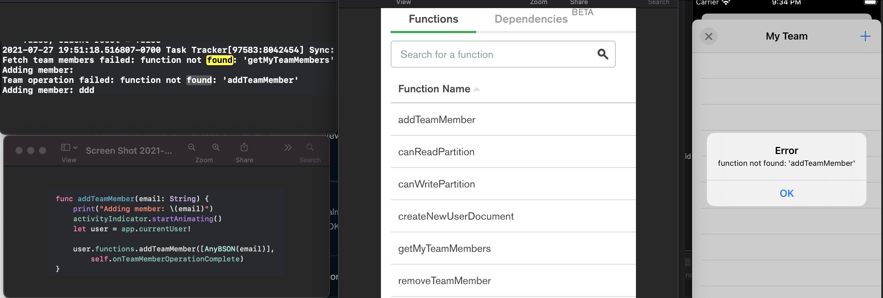

I am building sample Task Tracker app from here:
https://docs.mongodb.com/realm/tutorial/realm-app/#std-label-tutorial-task-tracker-create-realm-app
  • Following the instructions, I created the back end using the CLI tools.
  • I downloaded the sample iOS app and I am able to create accounts, log in, create data.
  • When I try to add a team member using email to share data I get an error: “function not found”
  • I’ve attached screenshots to shot the function is setup on the back end with the proper names.
  • I suspect a permission issue, but I’m unable to resolve the issue.

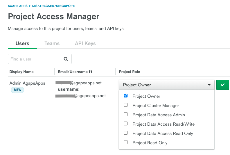

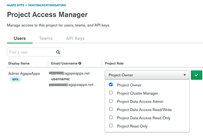

One permissions issue I had, was due to my mistake in following the backend tutorial: make sure you select “Project Owner”
Your issue may be elsewhere. Also check, if you see all the functions in your Realm App. If my suggestion does not work, just set it up again from scratch on a different MongoDB server.
