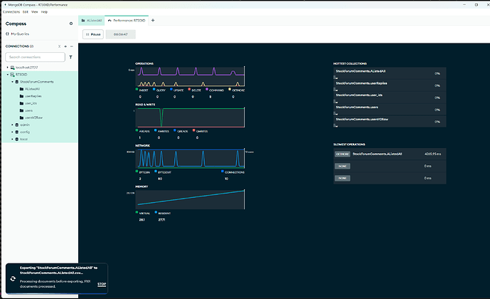

  2. I tried to export the query result from Compass
    I don’t know much about how Compass exports data. But it seems that compass is handling documents in chunks of 1000. As the spikes in the network suggests, MongoDB doesn’t take much time to process the first several batches of documents. However, it is becoming more and more slow as the batches it has processed grow. Since my specific query matches 789140 documents in the database. It is likely that the query would take a long long time to complete, which appears to be stuck when working with pymongo.
