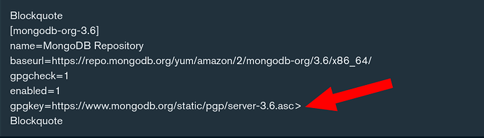

after setting up the code /etc/yum.repos.d/mongodb-org-3.6.repo
[mongodb-org-3.6]
name=MongoDB Repository
baseurl=Index of x86_64
gpgcheck=1
enabled=1
gpgkey=https://www.mongodb.org/static/pgp/server-3.6.asc>
sudo yum install -y mongodb-org-3.6.23 mongodb-org-server-3.6.23 mongodb-org-shell-3.6.23 mongodb-org-mongos-3.6.23 mongodb-org-tools-3.6.23

Also that’s not a typo?
Also looks like

Thank you for the much needed help, the config file was a typo :wink: but only in the blog (must have hit the> key), the deltarpm has fixed the issue though, looking at the migration path now…
