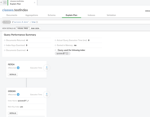

Hi @Pavel_Duchovny
I tried the query using Mongo compass and Mongoose (NodeJS) and the index quizzes.done is NOT used even though a multikey index should be created as you say.
Take a look at the following screenshots for confirmation:
https://i.ibb.co/JvXmxr9/Screen-Shot-2020-08-19-at-11-18-43-PM.png
https://i.ibb.co/WDxxcZC/Screen-Shot-2020-08-19-at-11-18-51-PM.png
If I modify the query to be like
Answer.find({ 'quizzes.done': true }).explain('queryPlanner');
The index gets used.
However the fastest index that works that I found is quizzes.0.done but this is not dynamic enough.
This means I would have to create quizzes.1.done quizzes.2.done …etc which does not make sense.
Thanks!

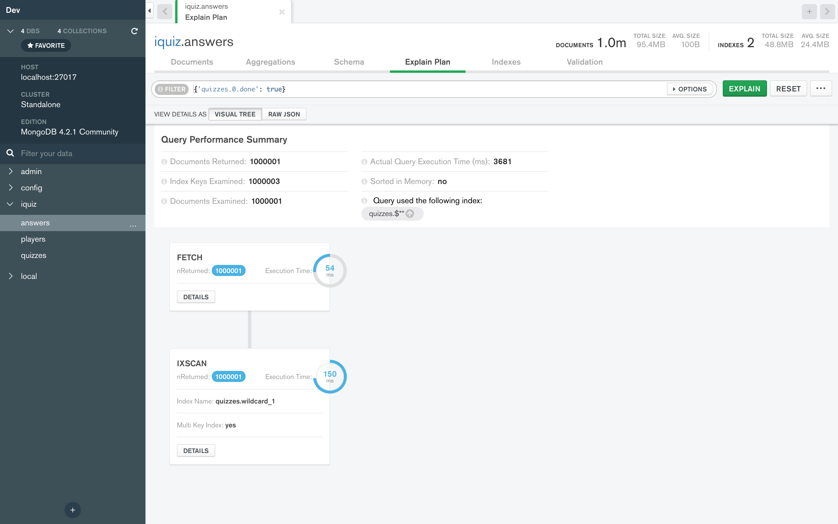

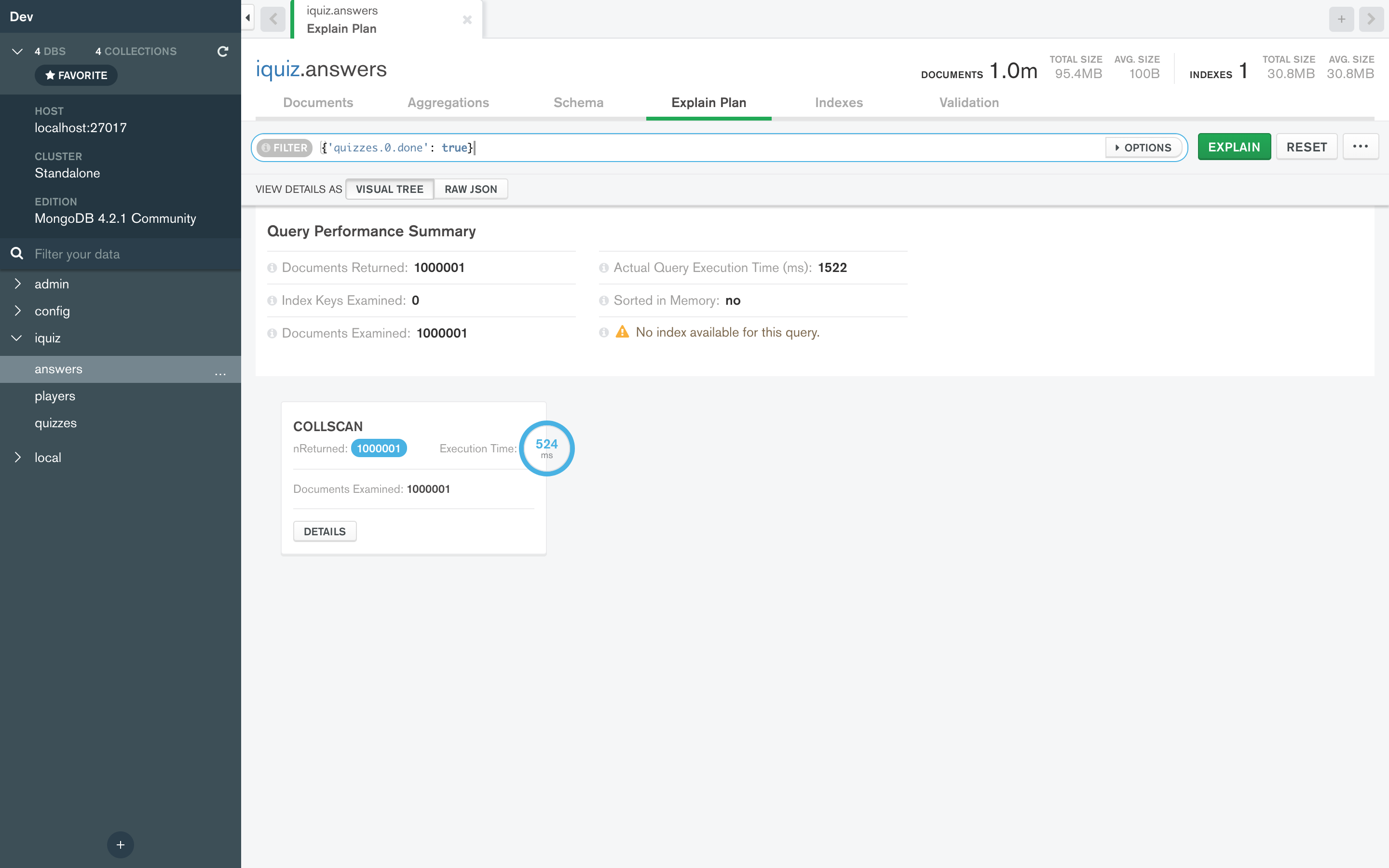

Hi @Pavel_Duchovny
Yes, the wildcard index quizzes.$** gets used but it’s much slower like I explained before.
Judge how it performs on a large database:
Even without any index at all it’s much faster:
If by multikey-index you mean just quizzes, I tried it and it won’t get used by the query without hinting.
With hinting, the multikey-index would be as slow as the wildcard index above.
Thanks in advance
Regards
Michael
Hi @Michael_Azer,
Looks like all documents needs to be scanned to get the values so an index scan will not make sense but a full scan might be optimal.
The scans are better then full index scan like the one you showed.
Why would you specifically query a position element? I mean maybe there is a better query for what you are trying to achieve.
Best
Pavel
