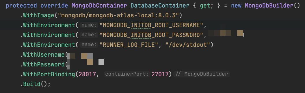

For future users, this was resolved by adding this. Thanks to all who jumped here to help :slightly_smiling_face:
CleanShot 2025-05-21 at 12.57.03@2x
