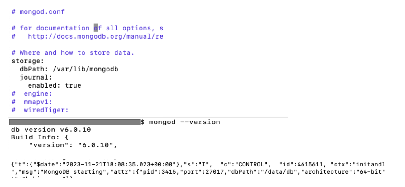

My original dbpath was set to /var/lib/mongodb, but after the update, a /data/db directory was created, and it seems to have become the new dbpath. As a result, MongoDB fails to start.
I also noticed that a mongod.conf.dpkg-dist file was created, but it doesn’t seem to have any significant differences. I’ve tried running the following command, but it still fails:
mongod --config /etc/mongod.conf
Could you please help me identify the cause of this issue? Thank you.

What are the differences between the “mongod command” in mongod and the “log” in MongoDB?
In mongod.log, it refers to /var/lib/mongodb as the dbpath, while in mongod command, it specifies /data/db as the dbpath.

From where you got the above snapshot which is showing dbpath as /data/db
