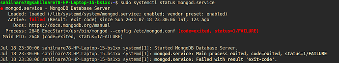

I implemented the key file authentication from the docs but now I’m getting a new error.
In text:
● mongod.service - MongoDB Database Server
Loaded: loaded (/lib/systemd/system/mongod.service; enabled; vendor preset: enabled)
Active: failed (Result: exit-code) since Sun 2021-07-18 23:30:06 IST; 12s ago
Docs: https://docs.mongodb.org/manual
Process: 2648 ExecStart=/usr/bin/mongod --config /etc/mongod.conf (code=exited, status=1/FAILURE)
Main PID: 2648 (code=exited, status=1/FAILURE)
Jul 18 23:30:06 sahilnare78-HP-Laptop-15-bs1xx systemd[1]: Started MongoDB Database Server.
Jul 18 23:30:06 sahilnare78-HP-Laptop-15-bs1xx systemd[1]: mongod.service: Main process exited, code=exited, status=1/FAILURE
Jul 18 23:30:06 sahilnare78-HP-Laptop-15-bs1xx systemd[1]: mongod.service: Failed with result ‘exit-code’.
I’m not sure where this error is coming from.
