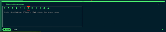

You can attach files using the box in red. Alternatively you can use markup and paste the log file directly in here. For example:
