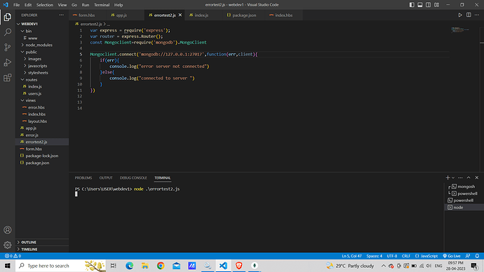

This is my source code. My terminal is stuck like this
Did you verify that mongodb server is indeed listening on 27017? you can use something like netstat to check that.
And if yes, does mongodb log show anything?
Screenshot 2023-04-28 221208
It says ‘Established’, but my terminal is not showing any further output or response, or it appears to be still running.

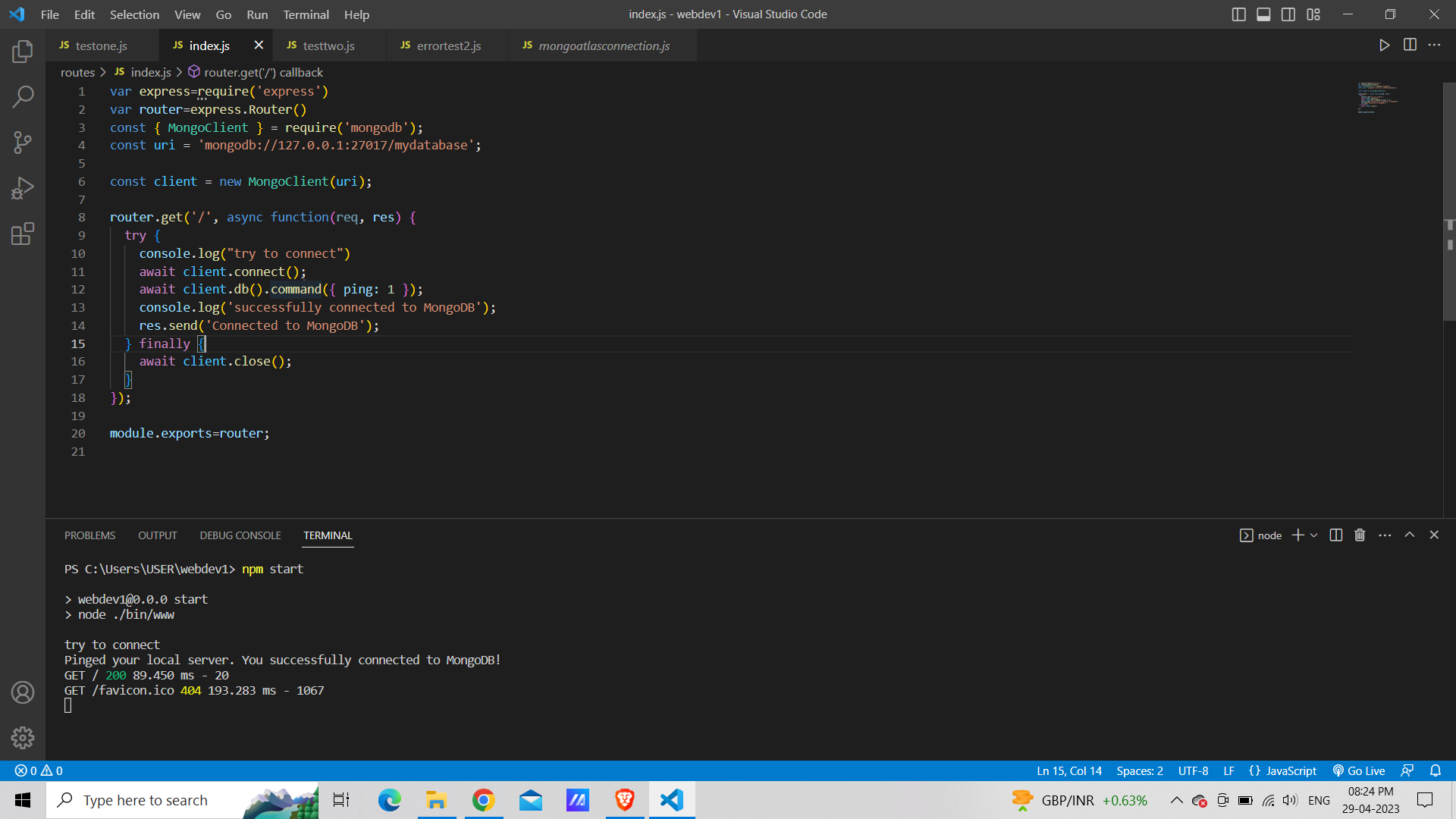

I solved my problem with this code .Thankyou all for your support :heart:
To make better use of async/await, you can say this "new MongoClient(uri)" is the modern way to use the driver. Keep that in mind when you read old tutorials with lots of “callback” functions.
anyways, with this working code, will you please also use "localhost" instead of "127.0.0.1" to check for IPv6, because part of your resolution is not clear about this statement:
