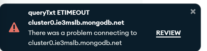

Yes, I am able to connect localhost locally but thing is I need to have access to the Cloud services as I have to put my web on a web hosting platform nearing the end of the class this semester. As per the image, I tried to use MongoDB Compass to connect to my cluster, it doesn’t work too.

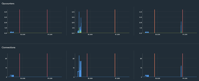

As shown in the image above, I was able to make connections with the db 2 days prior too so atm I’m a bit lost, my Cluster is active and fully operational too according to my Atlas account

The error here is that compass cannot look up the TXT record for the cluster, this is a DNS error.

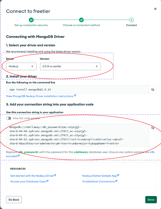

Try changing DNS setting to another provider. If that does not help then use the legacy connection string format. Selecting an old driver from the connect button of your cluster in Atlas will show that.
