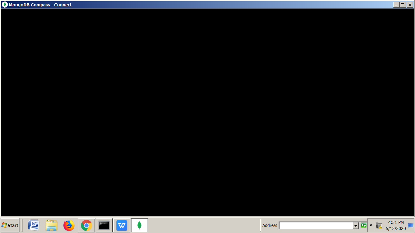

Hello, I am new in MongoDB, I installed shell & its working fine. I also installed MongoDB compass, when I run it displayed blank screen & not able to do anything … I tried lot but not able to solve this problem…

- Does the black screen appear right after opening Compass or does it happen while trying to connect to a MongoDB instance?
Hi, I am using compass version 1.21.1 stable.
OS Windows 7
Blank screen appear right after opening compass, as I posted screen shot in my previous post.
Shell is working fine.
Yes, shell is working fine. But not able to see anything in compass screen due blank screen. Even not getting option to set host string or connect string. I have mentioned screen shot in previous post

I have the same issue. W7, blank screen on startup of Compass. have installed 2X exe and msi, no difference, just hangs. 1.21.1. rebooted in between. W7 home premium fp 1. does respond to close action.

Thanks, I tried the GA zip and the beta versions, same issue. It’s running, I see 3 processes in task manager just no gui. I’m getting a new W10 PC next week as a workaround.
Solved! After installing .net 4.8 and various other windows updates, it works now.
