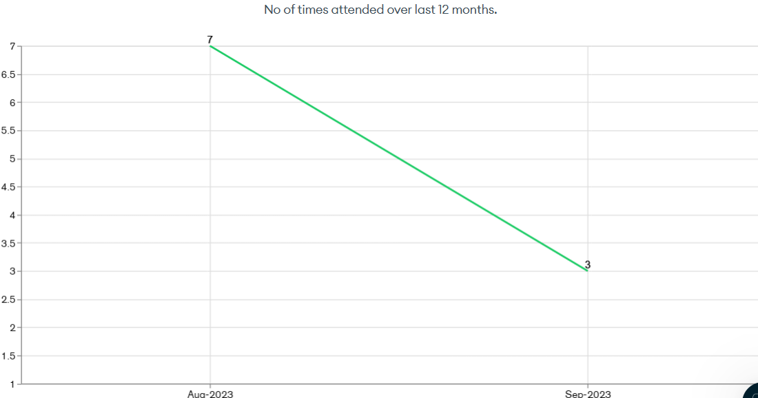

Bar or Column charts, Aggregation axis is displaying values as decimal values. There is no issue with data retrieval. It is getting the correct value, but the value display isn’t right. Number of people can’t be displayed in decimal values. How to fix this? I tried everything in customize options. Nothing worked.

Go to Customize option and in field portion select your axis. Under that you will find Number formatting where you can toggle off the Decimals field.
