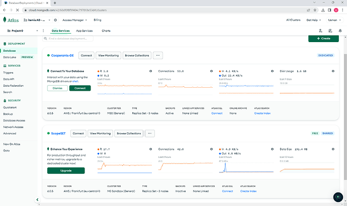

I have a spring boot microservice that communicates with the MongoDB cluster deployed on MongoDB Atlas. The mongodb driver version is 4.6.1 In this microservice, we actually trigger some functions if data is inserted, updated, deleted in some specific collections. For catching these events, we are using mongodb-driver-reactivestreams library. I am facing a srange issue. I have 2 clusters in MongoDB Atlas that can be seen below in the following image:
The microservice starts without any errors if i try to connect it with the first cluster Cooperants-DE but when i connect it with the second cluster ScopeSet I see this error in the logs when microservice starts
