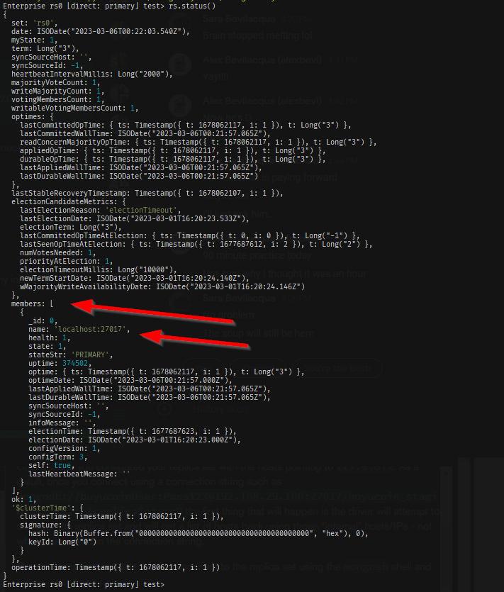

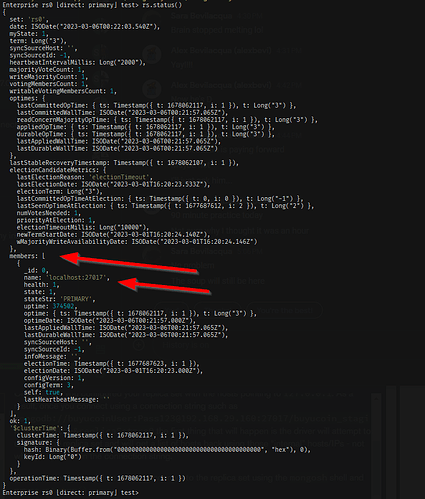

But I could not understand why it is always trying to connect to 127.0.0.1 when I passed a different IP as well.
Chances are you configured your replica set with the hosts pointing to 127.0.0.1. As a result, once you connect using a connection string such as mongodb://buyucoinUser:Pass123@192.168.29.160:27017/buyucoin_stagin?ssl=false&replicaSet=rs0 the first thing that will happen is the driver will attempt to discover the replica set and will get a list of hosts back using those “internal” hosts/IPs - not what you passed in the connection string.
The easiest way to validate this is to connect to the replica set using the mongosh shell and run rs.status()
This will output an array of members in the set that includes details such as the state of the member (PRIMARY, SECONDARY … etc) and the name. The name here is the host/port for that node.
Assuming you have your mapped to either 127.0.0.1 or localhost (like the example above), you can fix this by reconfiguring the replica set.
As an example, let’s say you have 3 members on ports 27017, 27018 and 27019. If you wanted to configure the replica set to map these nodes to those ports on IP address 192.168.29.160, from the mongosh shell you would do the following:
var c = rs.config();
c.members[0].host = "192.168.29.160:27017";
c.members[1].host = "192.168.29.160:27018";
c.members[2].host = "192.168.29.160:27019";
rs.reconfig(c);
Once the replica set is reconfigured, when your application connects next it will discover the replica set members and try to connect to them on the host/port pairs that you configured above.

You are right, using rs.status() members are shown as below
